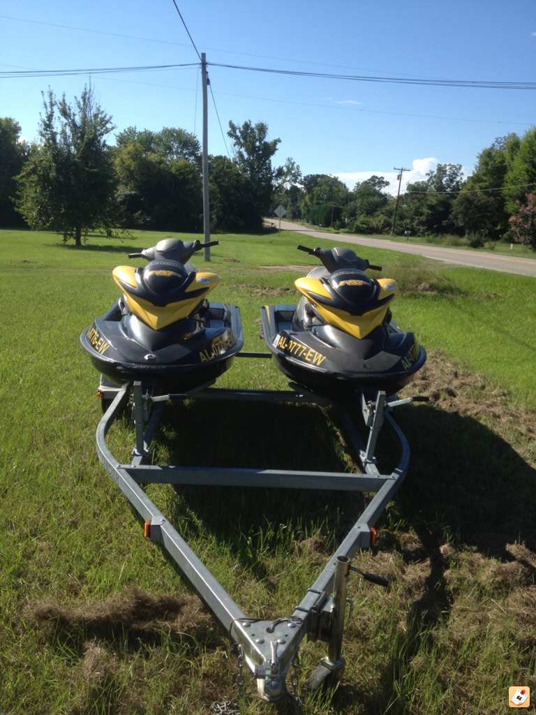

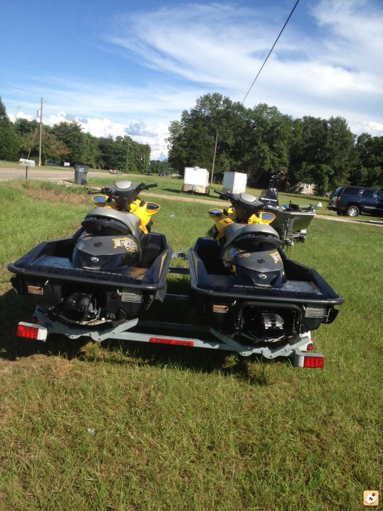

Some pics to help

Those look like 155's....no sc ic stickers on them.
Agreed. These look exactly like my RXP 155 (NA) ski. Same stickers and everything.
Top speed around 52-55mph so far. (haven't hit glass-like water yet)
