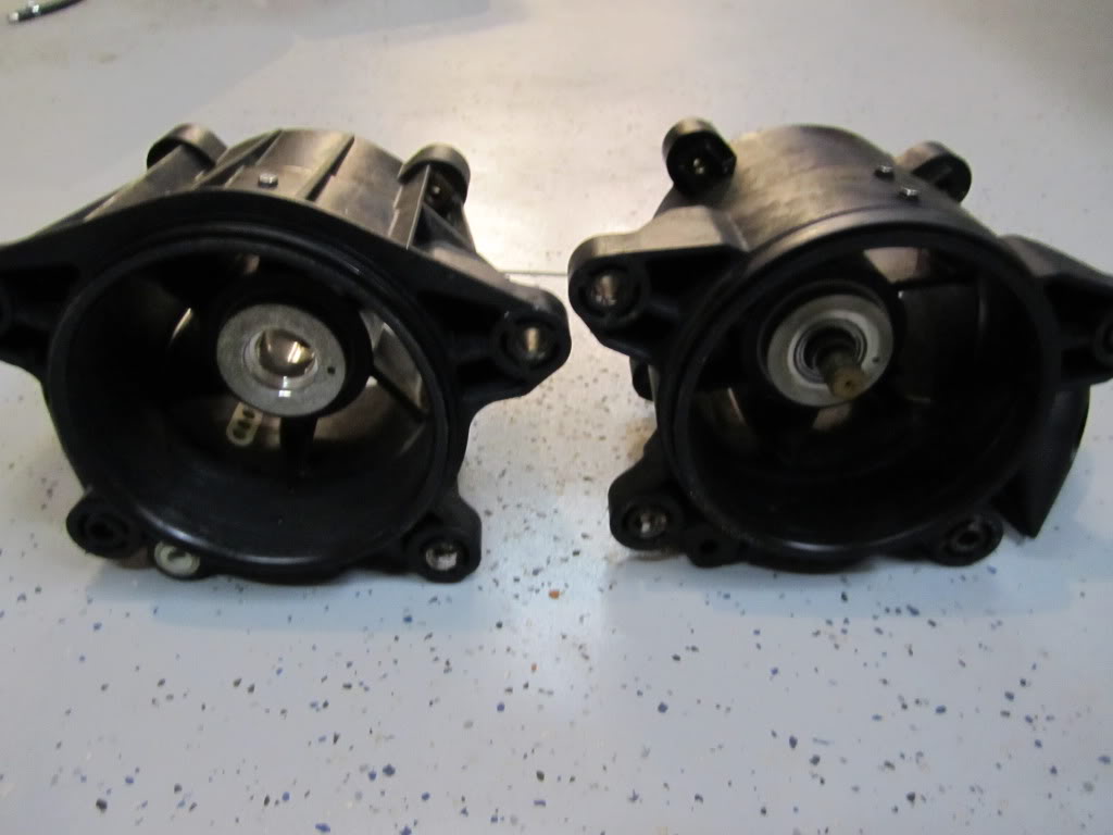

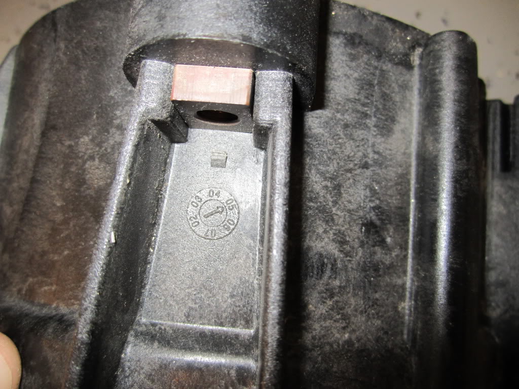

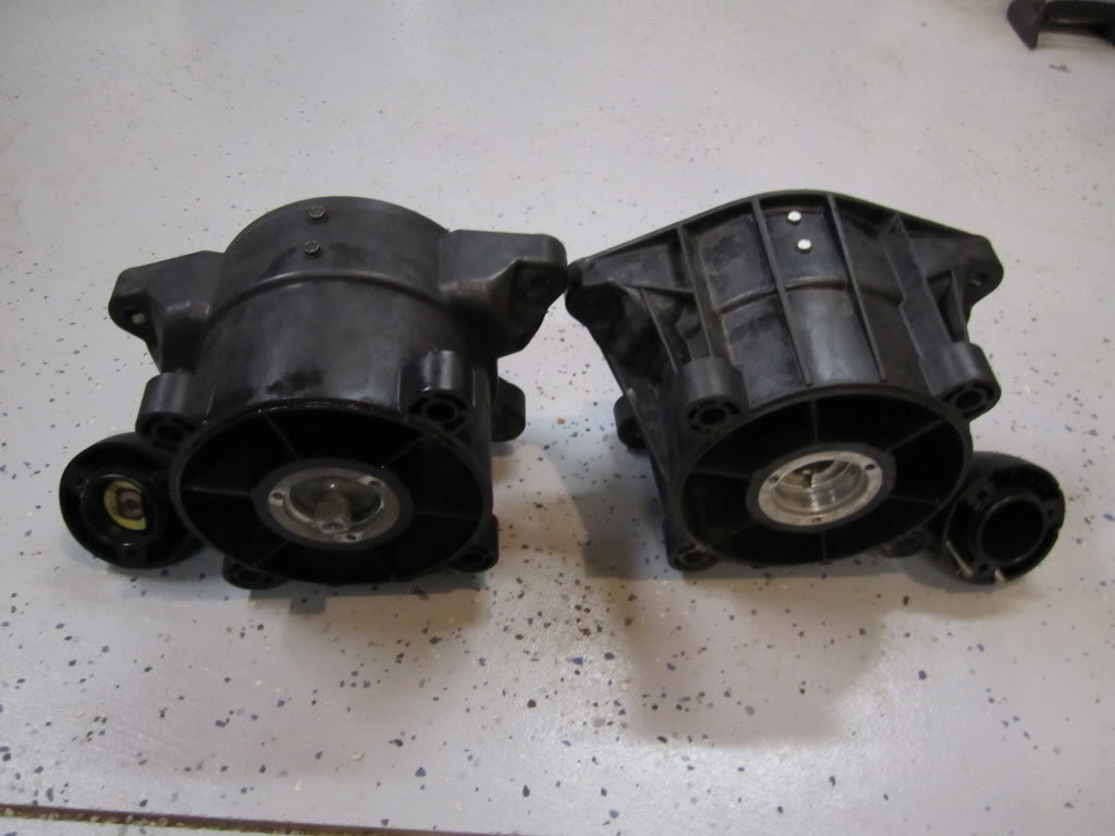

I bought a 98 GTX 951 pump housing for my 00 XP 951 and am trying to order a rebuild kit for the 98 housing, why are the part numbers and price different for the 98 over the 00 housing? Also I cannot find out any info on if this will even work on my ski as the 98 housing does not have the spring and plastic peice in the cone like my 2000 does. The part number off the 98 housing is 271 001 363 but here is the kicker, it has a 2005 date stamped in the housing!!! Both housings have different part numbers too. Someone help me out, I got the bearings out and am ready to order. Here are the pics, the 00 housing has the shaft in it, the 98 is empty along with the pic showing "05" on the 98 housing, the housing is supposedly from a 1998 GTX 951. I am pretty sure this rebuild kit will work for the 98 housing even tho is does not say 98, just need someone who works on these to confirm it- http://www.pwcperformanceparts.com/servlet/the-385/SeaDoo-Jet-Pump-Rebuild/Detail

Pics added, both are plastic. I have tried to order pumps off seadoowarehouse.com for 98,99,00,01 and 02 (951 ski's) and the part number are different for all of them!!!!
