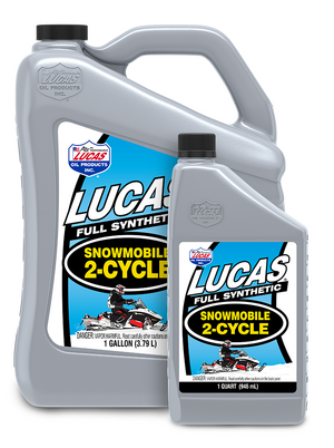

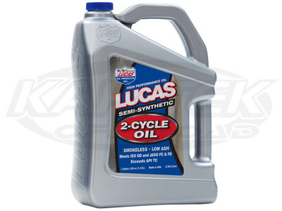

what oil do you guys recommend? lucas has API-TC oil but it says TCW3. don’t you want to avoid it.
If it was me I would only run full synthetic in a 947/951 the need all the lubrication they can get.
I use the Seadoo XPS 2-T in the black and yellow bottle.
Also Amsoil Interceptor is really good too.
