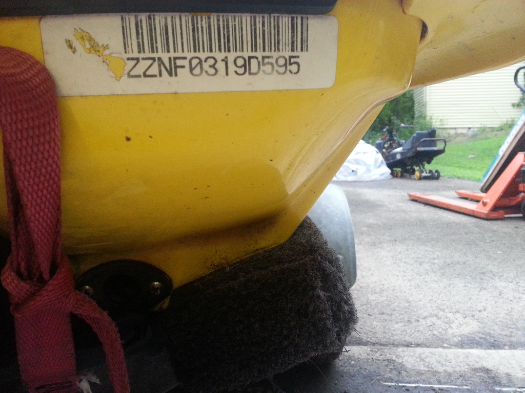

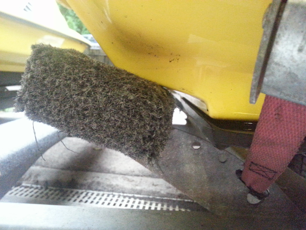

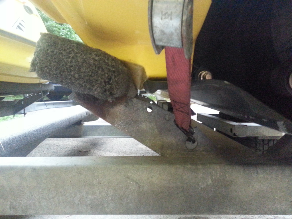

Ok, so this isn't measurements, it's pics. That is better in my mind. You can see I basically rest on the chines in the front and down on the under side of the hull. The rear is kinda "locked in". When I leave the ramp down the shore and head to my parents place I don't strap the backs down, it's about 10 blocks away and has some bumps along the route. The HX and XP are just like I left them. This set up does look weird but it works for me. So, I would position close to this and then loosen the hardware and pivot the bunks until you mimic this set up. My single is set up the same way and I can load my XP on that without changing anything.
You can see it basically runs the entire length kinda.
Thanks bro, that's perfect.. that is where I was trying to make it land.. I have to adjust the chines more.
