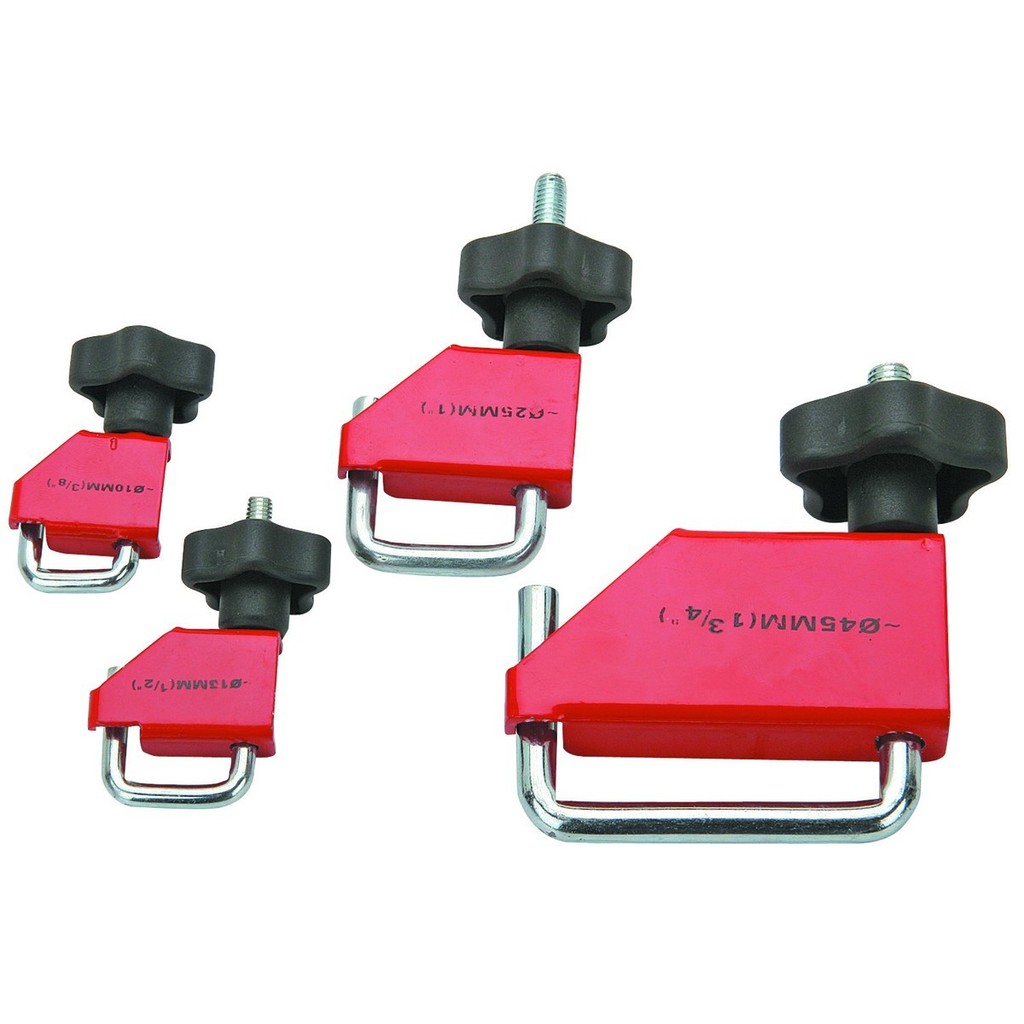

No. If you pull a ski and the engine is not running it forces water into the exhaust and then on top of the engine. Buy a ouch clamp and punch the hose that runs from the pump. This will eliminate the issue.

harbor freight.... $7
I keep one of these in my glove compartment and one in the parts bag.
