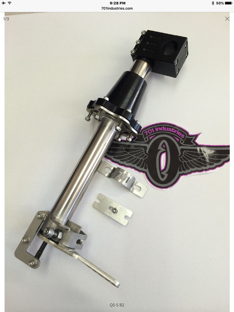

	That won't work on an x4 without heavy modifications still may not even workYes that's exactly what I'm describing. When at full speed on my 96 B2 1200 I can still veer left or right 3° without a struggle. My 97 SPX at full speed feels like I'm trying to arm wrestle The Rock. Maybe I'm just a big pussy and I need to hit the gym. I'm about to install UMI steering.

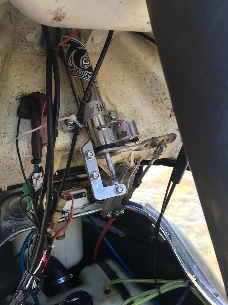

PS I think I've figured out a way to install suspension steering on my X4. I have it on my other ski and it makes a big difference on landing.
Notice the locking brake lever for trim and the use of Mtn bike parts to set steering farther back. Yeah I'm crazy, but it works really well.
If I install the same set up on the X4 it will put my weight back for better landings.

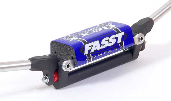

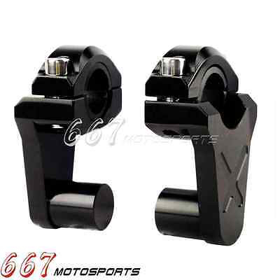

	Just buy 7/8 to fatty bar adapters, much easier and molestation free installation. Tons of options out there in the dirt bike world.Much easier way to add suspension steering. I'm keeping the UMI and adding these. Just need to machine the bar clamps to be 1 1/8"

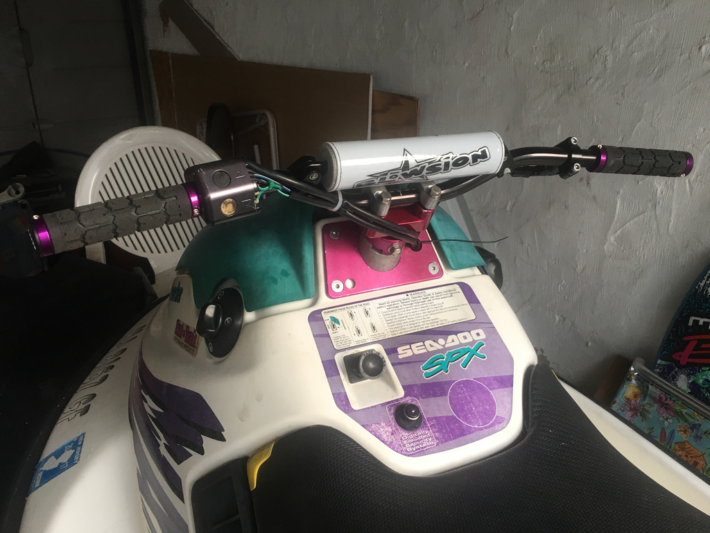

	Who made the re pop?
Did you score that ski in Jersey?It took me a lot of research to answer that question. R&D as far as I can tell. There are two holes in the front plate and it's pink/purple as hell. See link below
http://www.seadooforum.com/showthre...ER-Brand-new-X4-Steering-system-R-amp-D-Style
