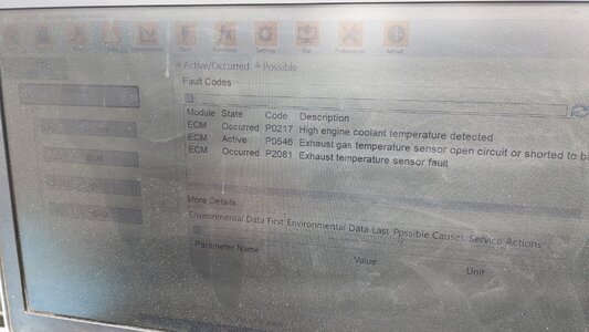

Since I just turned 30 hours on mine (I know it's very low hours) I figured it was due for some replacement plugs. I took the top off and inspected everything, I replaced the battery because it was showing 9.7 instead of 12.7 like it usually does (even after having it on a trickle charge to get it ready for the water), I swapped out the spark plugs and finally decided it was time to resolve the loud BEEP every time I take it out.

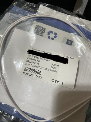

I went to my local shop and they were glad to try to sell me an entirely new wiring harness for my ski, however I just needed the electrical plug that plugs into the ETS, they said maybe check around FB Market for a broken ski to see if I could cut 8 inches off the broken one and use it. I looked and looked online and couldn't find exactly what I was looking for. I wasn't too thrilled about the entire wiring harness option so I stopped at my local Parts Department at the Chevrolet dealership, they had a very handy flip chart about 12 pages in total with nothing but large views of all the different electrical plugs (male and female) for the various Chevy's they service, this was were I found the answer to our problems. Mind you it wasn't cheap ($61.69 w/o tax *see attached) and they didn't have it on-hand however they could get it within a couple days. I figured it was worth it if it truly resolved this issue. *If a guy has a small person handy this could probably be done via the oil access and have the small person cut the zip tie that typically holds the wires to the support near the rear of the ski, but if you already have the ski apart then it's not big deal.
*If a person would rather order it online you can find it here:
ACDelco 88988586 ACDelco Wiring Connectors | Summit Racing for $34.99 w/o shipping or tax. It comes with pig tails so and fancy pinch connectors that have the heat shrink included, very nice I think, I did a solder job and ended up cutting them out and going with the pinch connectors.
Once I cut into the electrical plug about 1/2 inch from the plug there was wiring housing however there wasn't a wire in the housing for a good 2 to 3 inches from the plug. There is also the possibility to reuse that plug if you want to give it a go - (
