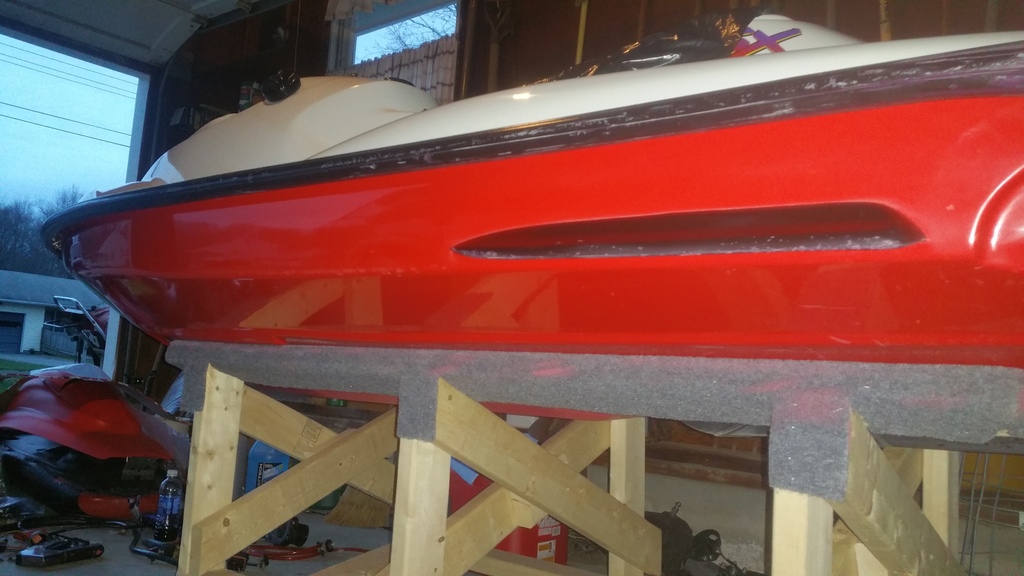

Sorry for the unnecessary pics lol anyways, fall came quick so it was time to get her ready for winter. i made this little stand for her to sit on.

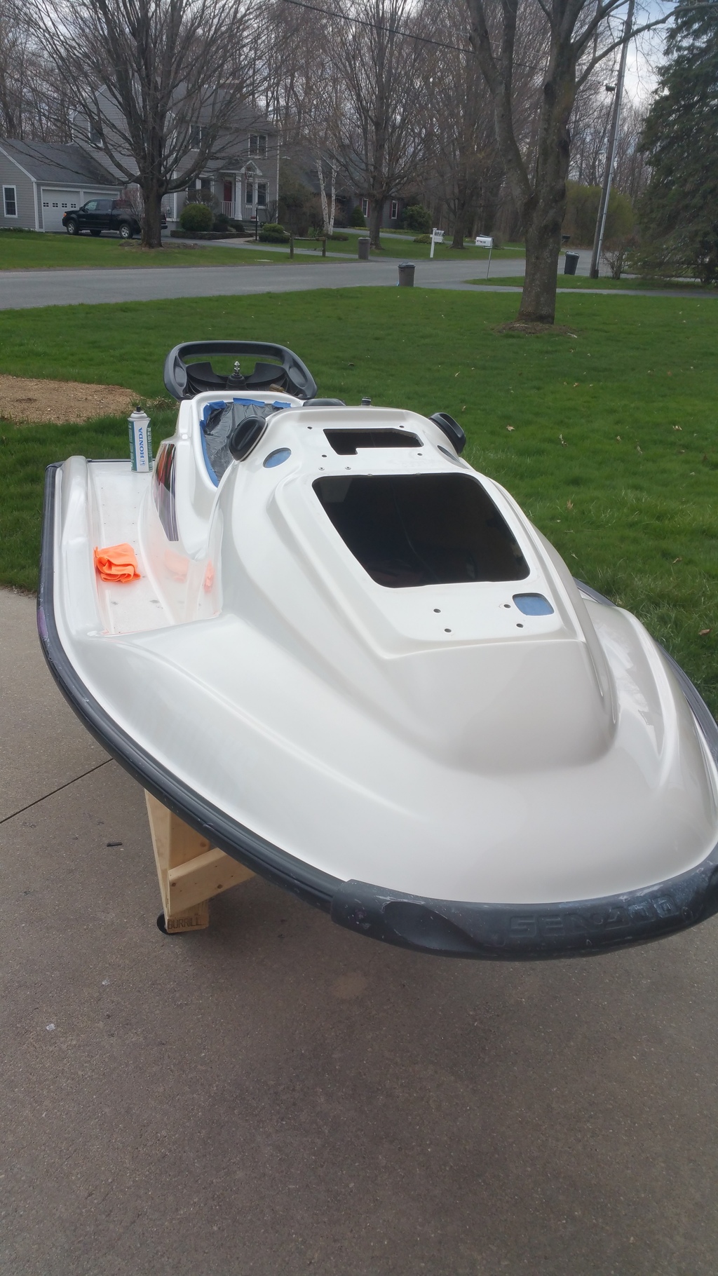

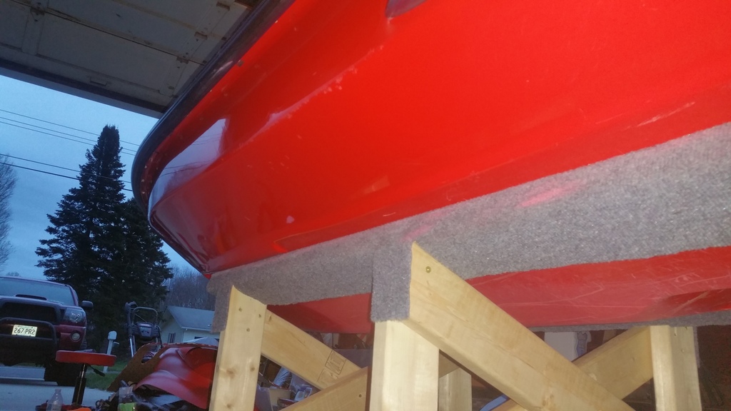

So i decided to buff the hull and restore the colors. I bought this Hula boat care 3 step gel coat restoration kit.
This stuff worked amazing considering i didnt wet sand as much as i should have. I did a little wet sanding before i put away for winter but i didnt start with course paper. I think i did 1000 grit and then 2000. It worked alright but definitely should have started lower. The red came out great, looks brand new but the white was really tough in some spots where old decals or stickers were, it took ALOT of buffing. Im pretty happy with it but i may try and re sand an buff where the old reg numbers were, its very cream colored around that area.

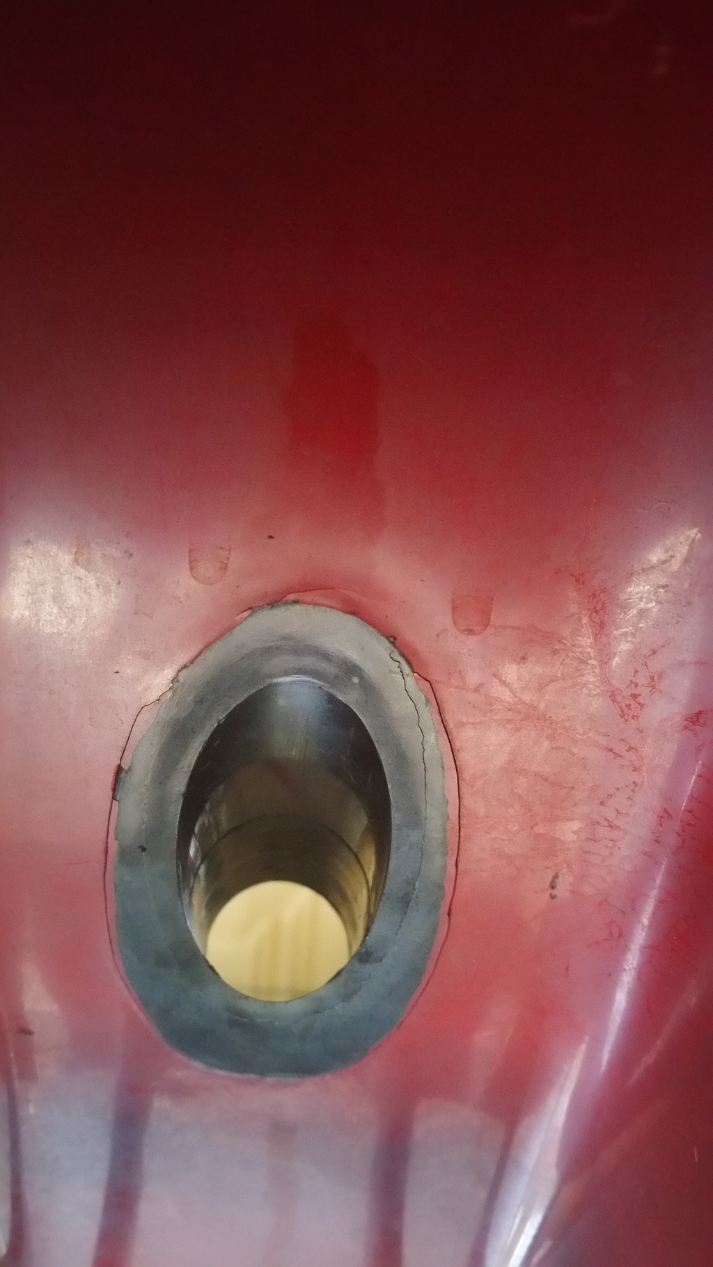

I also found this and was a little scared at first but after further investigating, I determined it is just cracking in the gelcoat because it is still very strong. I tried to put pressure around the areas and i couldn't make the cracks thinner or bigger. So im just going to seal it a little with some silicone or something.

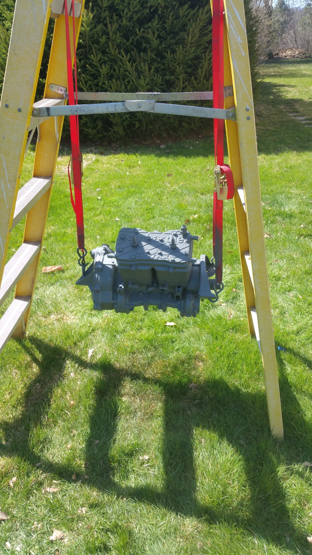

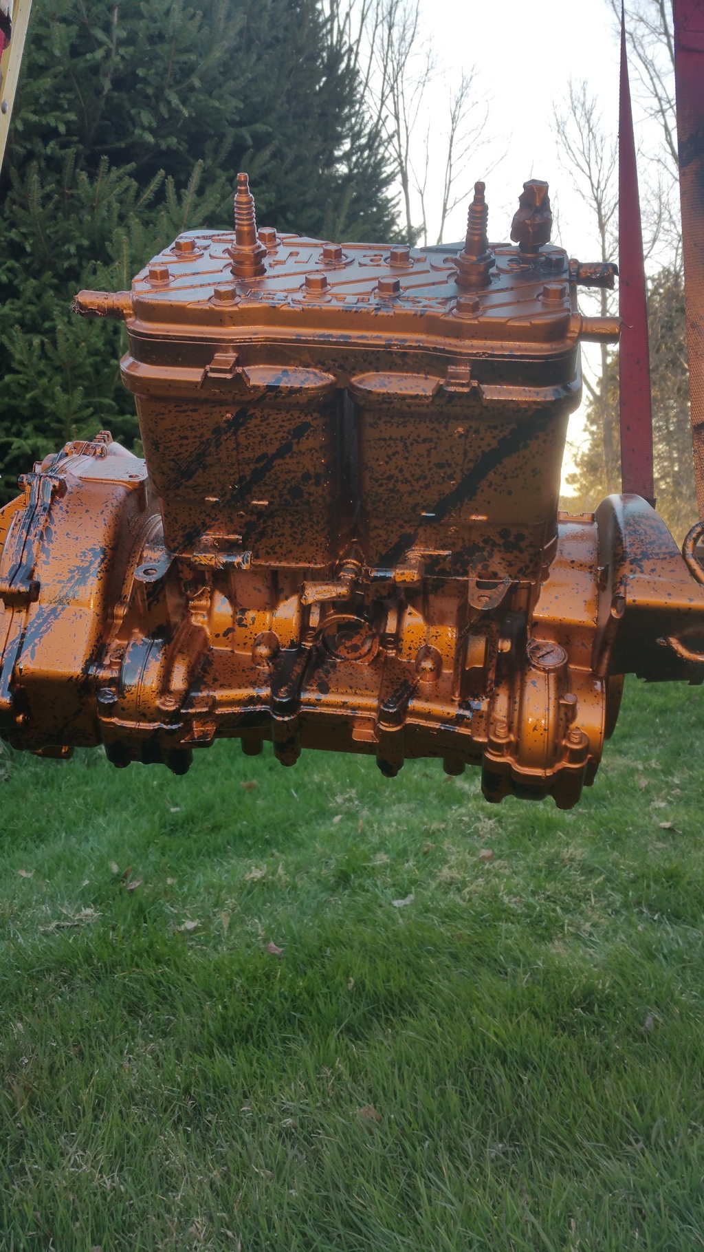

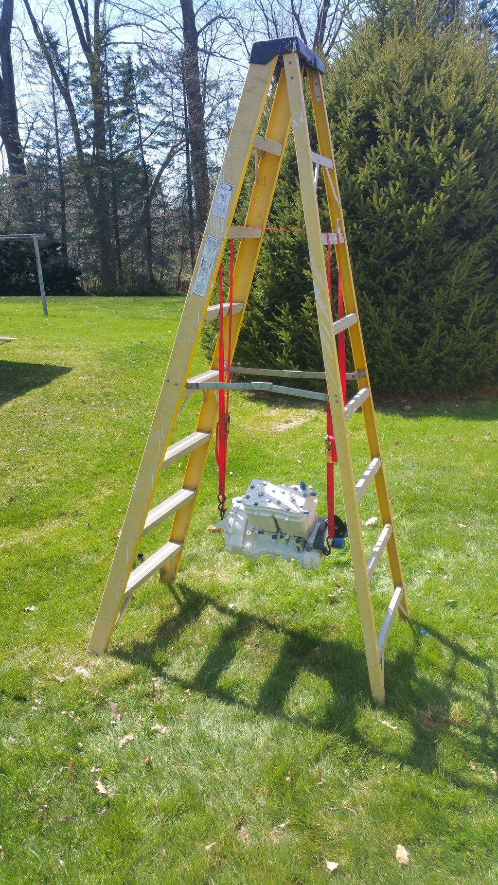

Had some perfect painting days weather wise so i went for it. Dont mind my way of hanging the engine lmao, it worked great btw.
Layed some primer down.

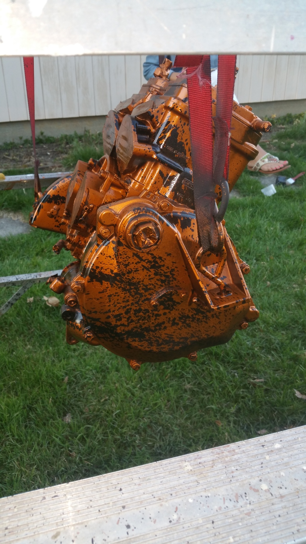

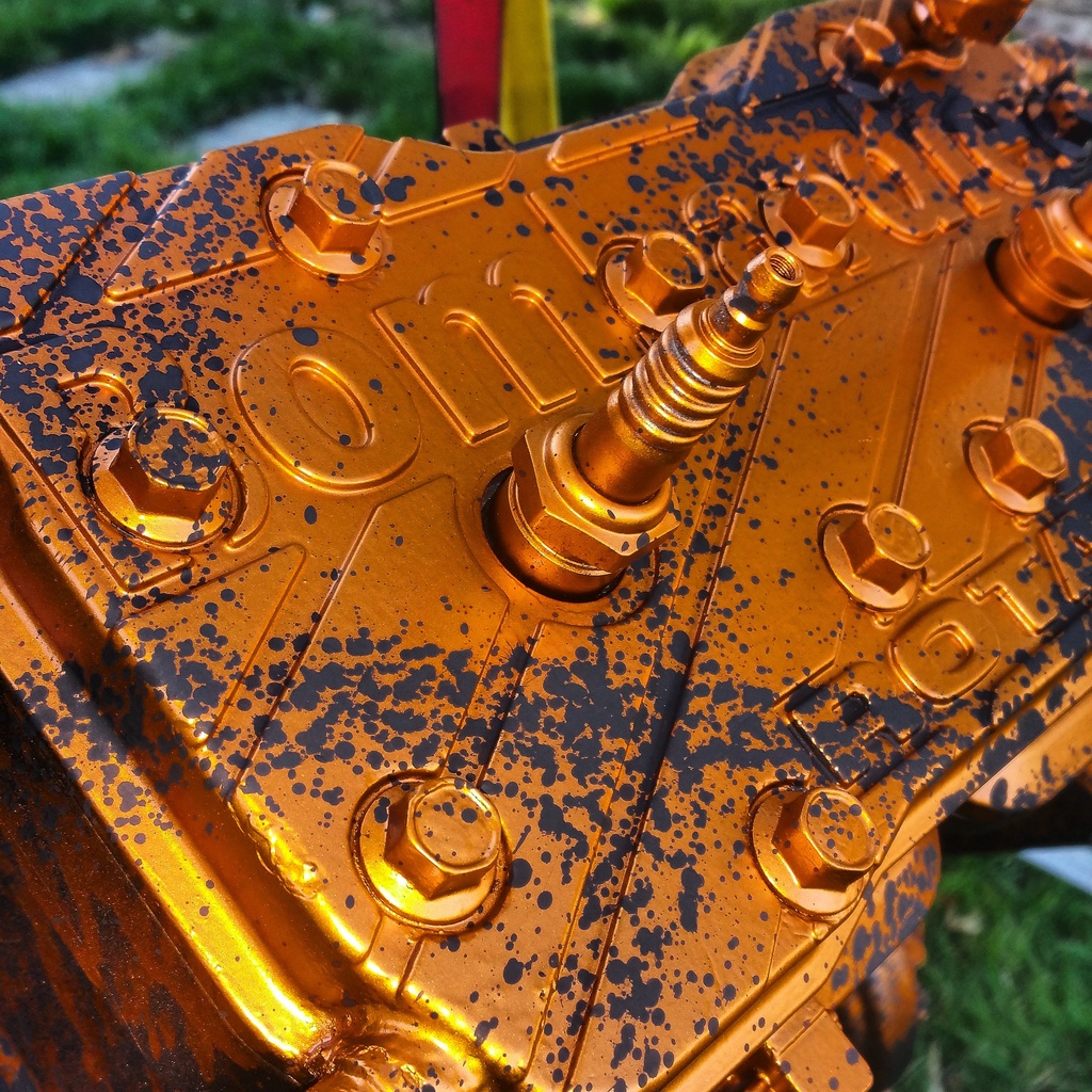

So i wanted to do the metallic red to match the ski (deff would have done the scheme different if i had that color). But at the local store they had a sale on the VHT engine enamel and of course all out of red so i went with the burnt copper and black for other parts. After i painted it all copper color it looked great but i got a little bored and my inner Picasso kicked in lol and this happened. I guess it came out pretty cool but not what i originally wanted so this will do.
Btw this copper color is super sparkly. It looks a little dull in some pictures but it looks awesome in the sunlight!

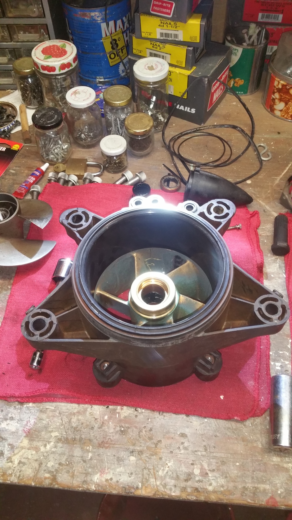

Then after that was all done i started on my jet pump rebuild.
It was pretty easy, i replaced everything but the impeller and the shaft. Once i got it back together i was a little nervous because the impeller would graze the wear ring in in 2 spots. A few guys on here told me its fairly normal and should shave down a little when i run it, so thats a little relief because i knew i had put it together right.

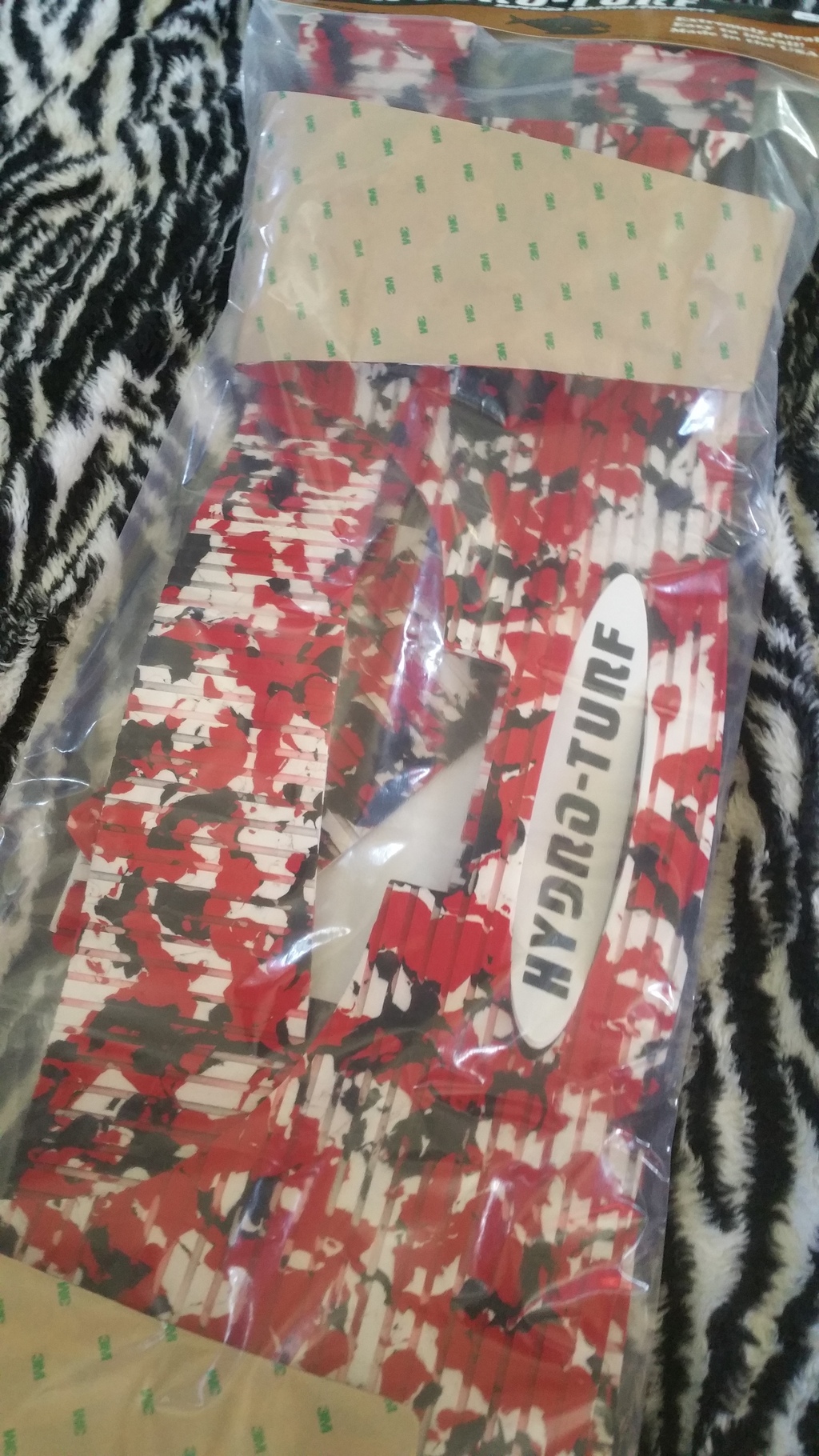

Hydro turf showed up!

LOVE that burnt copper colour not sold on the black yet though, it looks funky but looks a lil "theres a hole in the case and oil pissing everywhere" LOL
making me want to pull my block now! not found any of that colour anywhere in the UK in stock yet though, just as well, I'd probably paint everything I own
