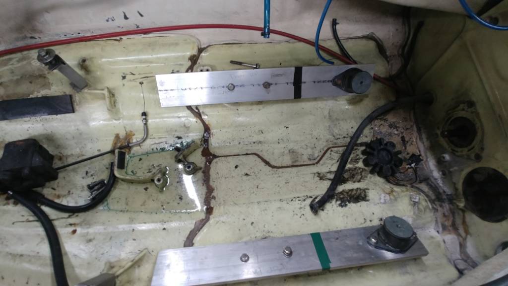

Run the backing plate to the table saw at a 15 degree angle tipping the sponsons outward in the boat handles noticeably and Incredibly better. If you look at all of the newest Sea-Doos there built that way. Stressful at best on keeping your fingers intact performing this task. LOL
What kinda saw blade did u use?
Im just running my carbide tip wood blade. It cuts aluminum fairly easily. I Run parts thru that table saw all day long at my stereo shop... manage to cut up a Yamaha today with our Sawzall. Lol. And some 3/8 aluminum bar stock for triple engine mounts in wave blaster
