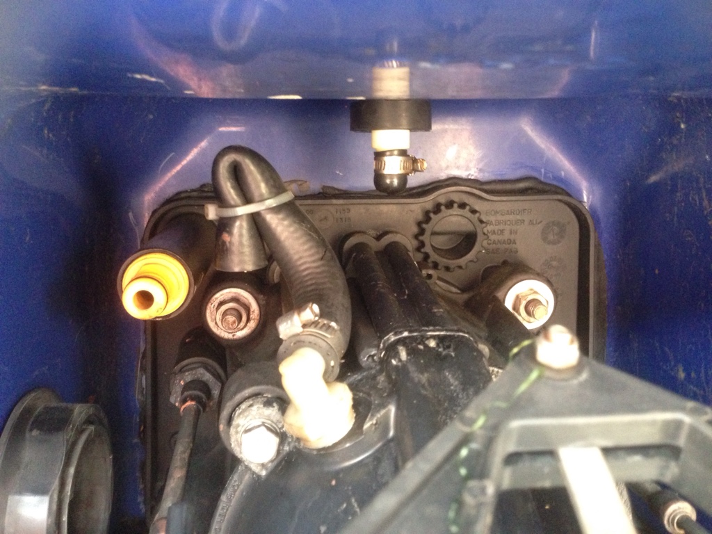

Hi everyone one I am new to jetsking can anyone tell me what the pipe in the picture is and what is it doing , should I connect it back up to the pipe with the stop end on it
I was being tow the other day with the engine running at idle and the ski filled with water about 7" deep
IMG]http://uploads.tapatalk-cdn.com/20160807/c2fb169c24b7b6836337a9b821fc864d.jpg[/IMG]
Looks like someone did an opas delete. That hose typically connects to the fitting that is plugged off above the pump. Usually when the opas is deleted a plug is put in the pump as well instead of leaving that white plastic barbed 90.
As for water in the hull coming from the top of your pump tunnel...,because the inside hoses prolly also have been removed? Clamp a short length of hose from one side to the other of that t fitting...effectively making a loop.
Gary, the proper O.P.A.S delete should look like this.
Go to the Riva Racing web site and order the kit. The part number is: RS29050-1. Call them and see if they still make the block off plate that covers the O.P.A.S. Valve. When searching, search for "O.P.A.S. block off" instead of "O.P.A.S. delete".
Almost forgot; are you riding your GTX with the flush adapter installed? It's the yellow part in the picture you posted.
Hi yes mine are blocked of as in your picture , just need to block off the top one above the jet and the one on the jet
