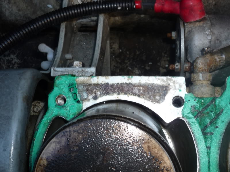

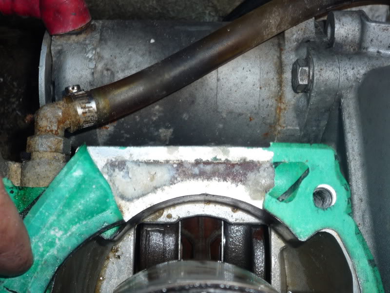

hi, im new to this forum,ive had a problem with my sea doo gti 2000,the problem was that there was no water coming out of the tel tail,i did all the checks and flushed the system out on the hose but the promblem still was there.
so i decided to strip the top of the engine down,to see if i could find a blockage,but no blockage was there instead i found this,a build up of salt or somthing like that under the gasket
what i did to test was i backed the ski in to the water and run it on the trailer for half hour or so,it didnt get hot,so i pulled the pipe of the drain and the flow was crap,not enough presure to send to the tell tail,so i pull the car and ski out and undone the drain bungs on the ski and loads of water came out,so i think iv found the problem,what do you think?? thanks for reading
