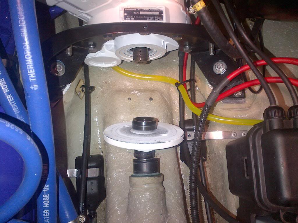

Well I did this last night so I could check for any water leaks. It did not go so well for me. Not only did I find a leak were my manifold connects to the cylinders, but my PTO came flying off.
This is from a newly rebuilt engine, I have no idea if it was not tightened on properly or because it has not been run in the water yet the driveshaft has not torqued the PTO on tight.
HMMMM. So when you sent your engine to ses, did they connect the manifold or was that something you were required to do? I have never seen the pto fly off, actually i have never even seen the pto removed. It looks like it is screwed in there and not pressed on? Can you just screw it back on there and tighten it down? I wonder if it is supposed to have threadlocker on it
The manifold is something that I had to install, not really sure why it would leak, I put new gasket on, and torques all the nuts to spec.
The PTO threads on, the problem is when you tighten it the motor turns.
81 ft/lbs is what it should get torqued to IIRC. I have an old bendix that I had mounted to a plate spanning the two starter holes to replicate the OEM flywheel holder. The rope in the cylinder would probably work, but I was always afraid to do it on a fresh engine. Or see if you can get just the right size nut to actually wedge in between the flywheel and the mag housing

Thanks for the tips. I will try locking up the flywheel to get that PTO torqued down. What do you use to tighten it, a pipe wrench or should I get the tool?

I use the splined impeller tool to torque it down with a torque wrench. I never used the copper spray, only rtv from the tube. As for pulling it, yep that's what I'd do. No point in working bent over and pissed off about it.
Yep use a torque wrench, rope in the cylinder is fine at that torque level, and yes, pull the motor- I'm down to less than an hour in my 720 powered skis, it just makes life easier. Wrap towels around the hull opening to minimize the scratch factor.
Should be good to go. Let me know how the flywheel holder works, I might have to upgrade from my cobbled piece.
