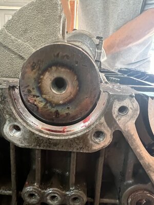

Alright I have been gone for a while. Life stuff got in the way. It im back at it again, I have tried everything dcm0123 has stated to try. Still nothing. It binds up really bad I even tried with no counterbalance in. I’m pretty much at the point of buying new main bearings. That’s the only thing I can think of. Will report back when I get new bearings in and seeing if that fixes it. I’m assuming it’s a clearance issue. But they are the original main bearings and were in good shape. I just really don’t understand. I have tried and tried to research and call a few mechanic buddies that do marine repair also and that’s what it’s looking like is bearing clearance issue. So I’ll go from there.
Okay I just noticed that when the crank is spun without the cases together. When you get to a certain spot one side of the crank lifts up slightly. And then doesn’t want to spin. Could that mean the crank is bent? Or bearings are shot?
Not likely. Probably just the resistance of the piston pushing it up. Can you push it back down?Take all the bearings out and clean them as well as the journals. Put them back in the same position making sure they are lining up properly with the groove. I would only put 1 drop of oil on each bearing. A machine shop will be able to tell you what's wrong pretty quickly.
