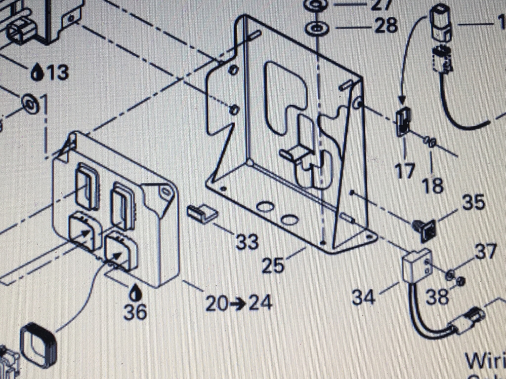

Where is the TOPS roll over switch located on a 2002 GTX? It isn't next to the MPEM..only the 2 main 30 amp fuses are next to mine. Manual isn't clear.

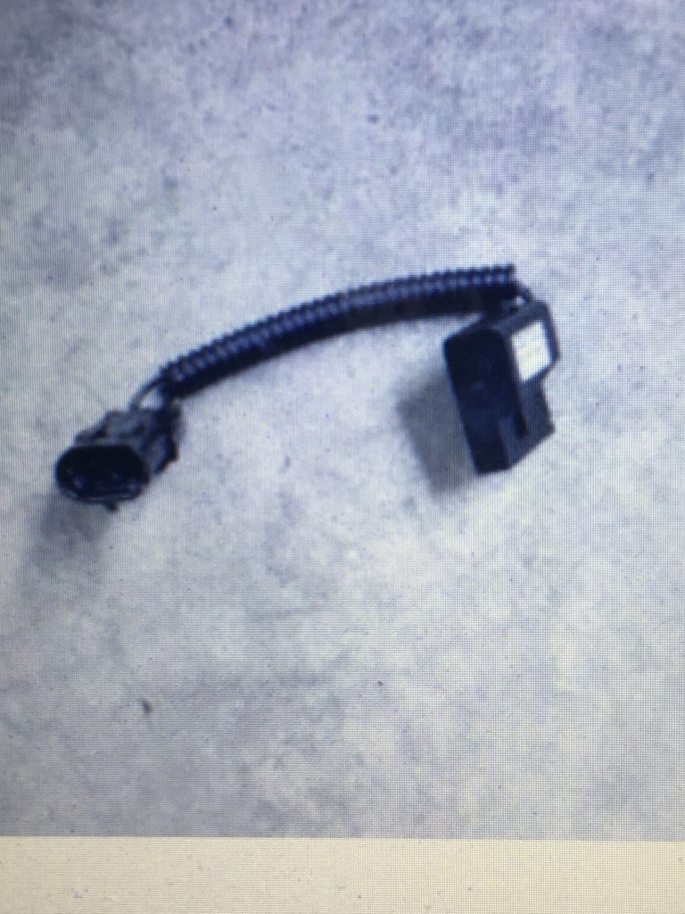

Here is a pic of the switch and general location. It is part number 34.
Thanks - got it! Didn't realize it was so small - just thought that was a lower plastic support for the MPEM
