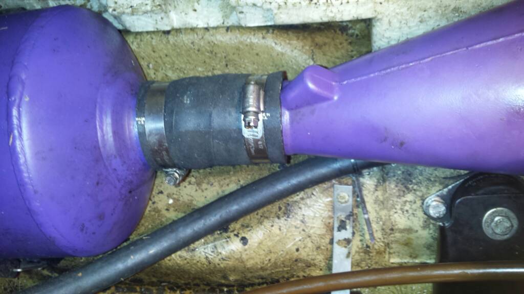

Are your fuel lines black or grey?
What color is your oil in the tank under the handle bars?

The oil is a light purplish color. The fuel line appears to be black.

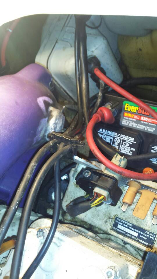

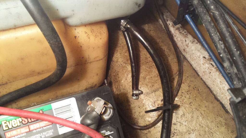

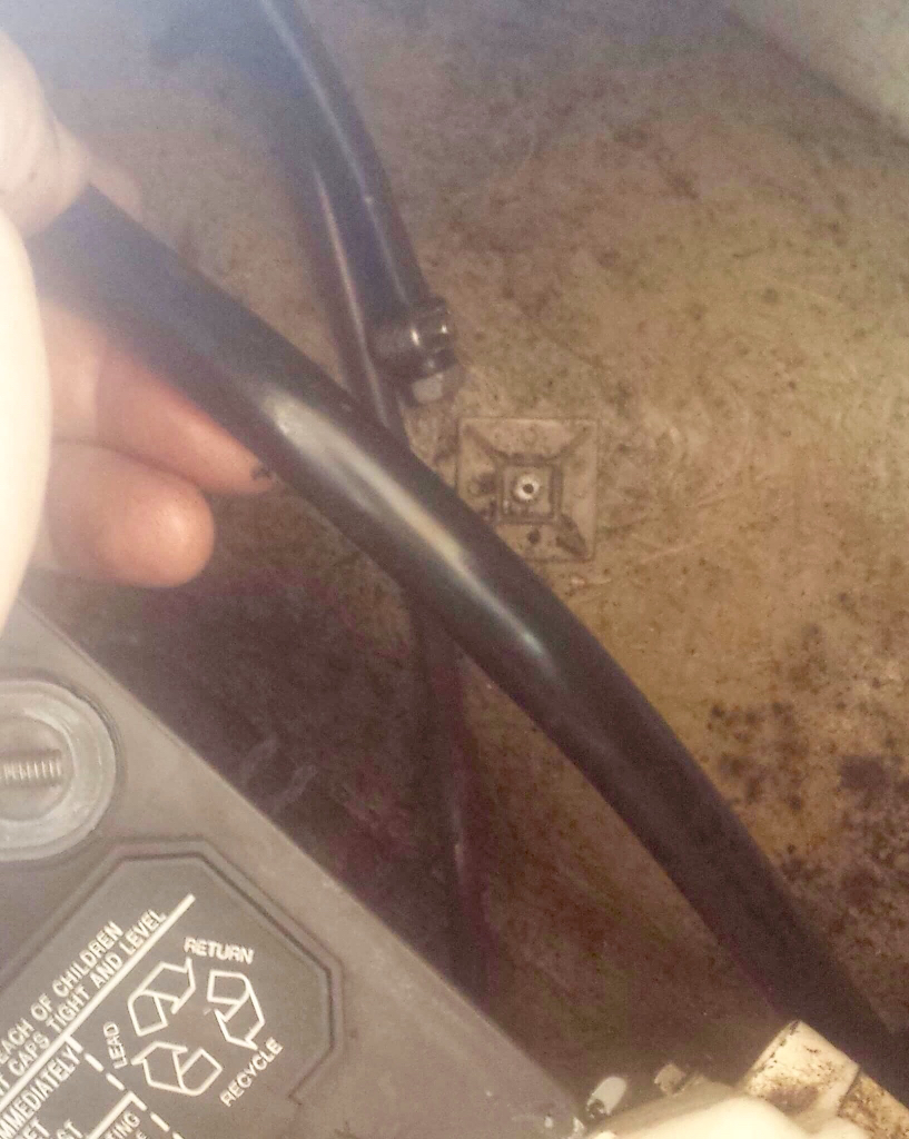

Those are pictures of the oil lines, not the fuel lines.
I think the mystic oil is purple and approved.
I suspected that was the wrong line. Definitely reflects my ignorance here but I'm determined to learn. I'm glad the oil appears ok. If it would help, I'll take lots of pictures throughout the inside and see if anything appears unsatisfactory. I'll do that tomorrow afternoon after work.

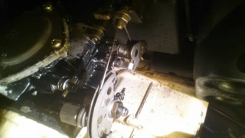

Post a picture of the carb side where the oil pump was and we can pretty much tell you if it is ok.

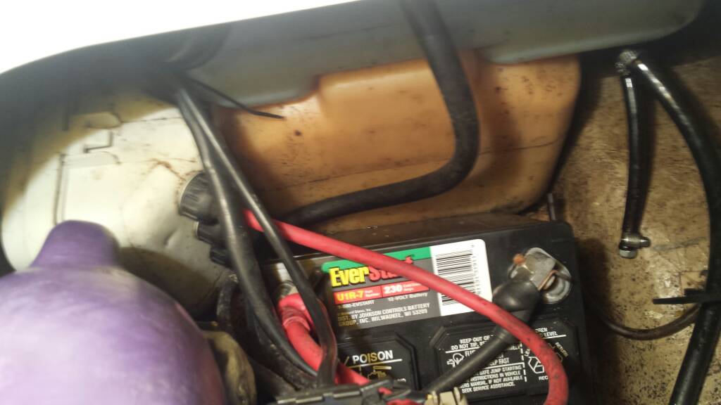

The battery. .... I know.

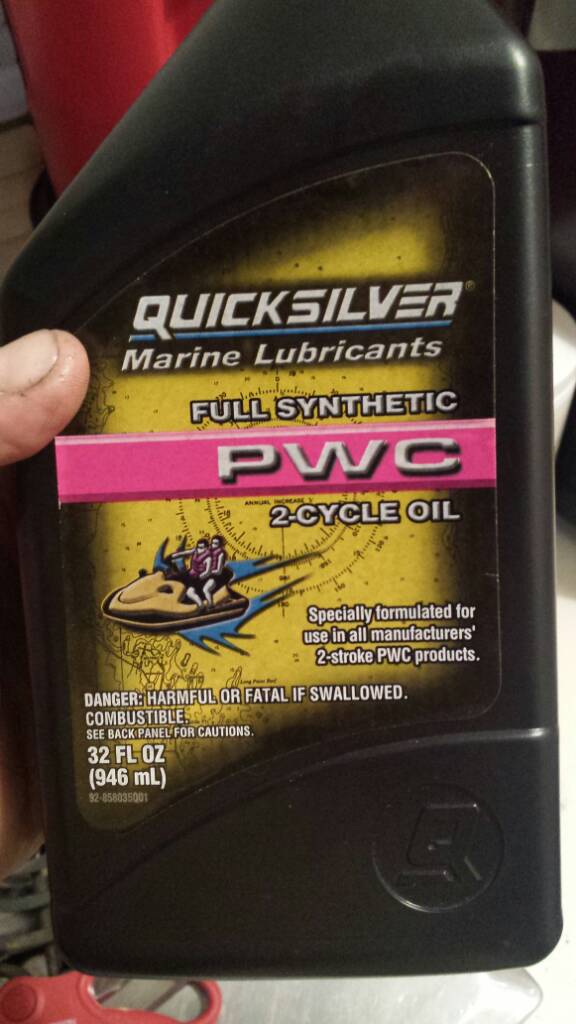

That's the oil used. What other pictures can I get to give more details of the condition? Thanks
The oil you show will work just fine; you do not need the full or semi-synthetic (mineral oil of the same brand will work fine in the 580 and 720 engines and is less expensive).

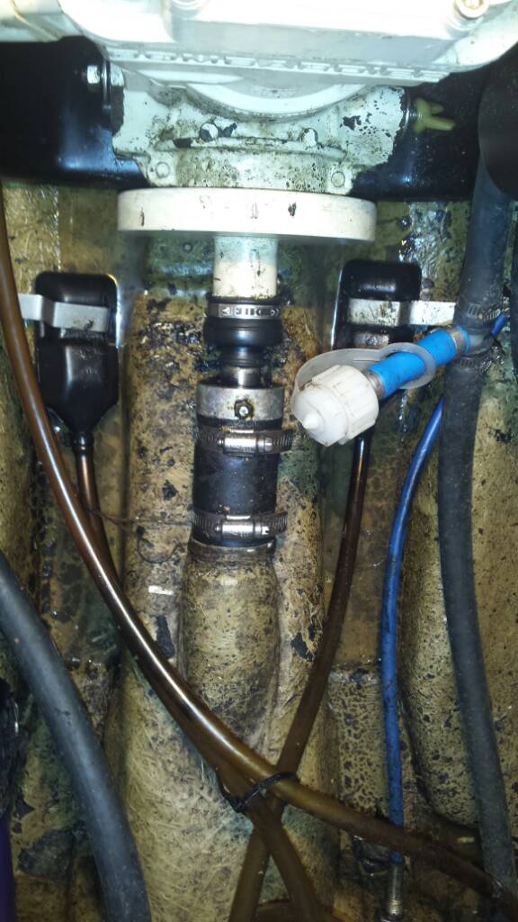

Oil tank is in place: good, the sealed off connection from the bottom of the oil tank formerly went to the oil injector pump. The other oil line from the bottom of the oil tank goes to connection under the carb for the RV gear lubrication. The oil line from the top of the oil tank should go to a connection under the exhaust manifold (return line from RV gear). This setup kinda implies there is oil circulation thru the RV gear, but not so ... only time new oil goes into the RV gear is when you drain/fill it or if you have leaking inner oil seal(s).
Looking good so far.
Well, yes and no on the oil.
Yes, in that it is the correct oil for your ski and as long as your seals are fine it should last a long time because it is only lubricating the rotary gear.
No, in the fact that Quicksilver doesn't list it on their website anymore so I am not sure how much longer you can get it. The only one they list now is not API-TC and it is a dual rated oil that is never recommended in a Seadoo.

This is the oil I use, and I buy it at Walmart. I contacted Quicksilver last year to make sure it wasn't a TC-W3 oil, and was suitable for API-TC applications. There seems to be much debate on whether this is okay to use or not. I am a fan of it, and I plan to keep using it in my 951's. The biggest thing is to drain a tank containing oil from an unknown source. One of my GTX's had a tank full of black oil when I bought it. I felt bad dumping it, but it was worth the peace of mind.
Water_PWC_Lubricants_PWC-2-Stroke-Oil---Gallon.png.250x250_q85_canvas_color-#f7f7f4_replace_alph.jpg
