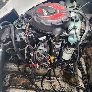

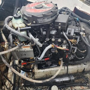

Hello all, let me start this convo of by saying I'm not engine savvy BUT can do relatively easy jobs & follow direction.
I recently acquired a 2003 Seadoo Challenger 2000 with a Merc M2 Jet drive V6 EFI.
The boat starts right up however is currently smoking pretty heavy (thick white smoke that lingers) . I have called around to aprox 25 mechanics (marinas, seadoo dealers, independent mechanics, trade schools, power sport places ) in the Massachusetts & RI area (I have also called local trade schools to see if they could help) and I've had EVERY person tell me they don't work on Jet drive. The only advice I was given was to bypass the auto mixing and mix the oil and gas myself - this does not seem like a solution that Is viable and I have not tried it. (Doesn't mean I'm correct here but if it's electronicly mixed in assuming it will cause other issues).

Welcome. I have same boat/engine.
The recommendation to disconnect the auto-oiler (oil pump) and premix is actually a highly recommended modification... due to the fact that the plastic gears on the crank that drive the oil pump get old and brittle with age and will fail causing the oil pump to cease pumping... which will cause catastrophic damage to your engine. That said, while troubleshooting... you might leave it as-is until you get it running right.
How long has/had the boat sat before you got it and started it? Looks like you are starting on the trailer... are you connecting the hose while running it? If not, limit start-run to less than a minute... and avoid throttling up... idle only. If it sat a while... the engine might just need a good running (on water) to get up to full temp and to "clear its throat" and burn/expel the excess oil that accumulated. That would be best case.
Is it possible the fuel tank is premixed (maybe by accident) and your auto-injecting oil... thus double-oil... and smokey?
There is a linkage rod that connects to the oil pump and to the throttle mechanism. More throttle = more oil. If this linkage came disconnected... the pump is designed to default to max-oil... and would be pretty smokey at idle. Worth a check.
Other maintenance items you should check/do: replace fuel filter/water separator. check lift pump (square one) pre-filter and/or replace. Test fuel pressure on top the VST (should be 35psi). Compression test your engine... looking for even compression on all 6. New spark plugs. Rebuild the pulse-driven fuel pump (diaphram kits are affordable) if unknown how old. Test voltage at battery with engine running... greater than 14v and you likely have a failed voltage regulator (2 on this engine... replace in pairs... I'm on my 2nd set)... this engine is rough on VRs. Pull the common power and ground lugs and clean/sand all terminal ends for good power and grounds. These are things I would do to a new-to-me boat with this engine.

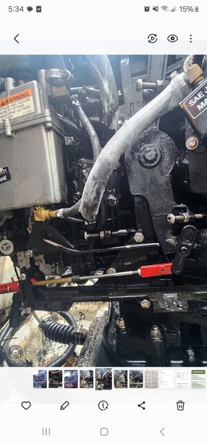

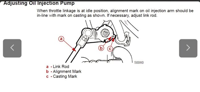

The oil pump in the pic is tucked in behind the VST (the gray tank , port side). Something else to learn- port vs starboard.
As shown in the pic, the pump arm should be at 9:00 at idle. Pump arm should move with throttle lever.

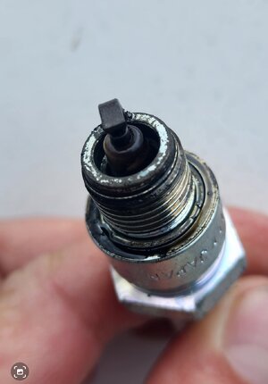

Bottom Starboard cylinder had a plug that was noticeably more soild then the others. (See attached photo)

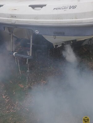

Also put in picture of smoke after changing the plugs.

Compression tests are done without starting/running the engine... only cranking with the starter. That said... you did get compression numbers your way... and they all seem in the same ballpark... at least none were zero or very low... which would indicate a problem cylinder. A better method is to pull all the spark plugs (allows engine to spin over easier... makes starters job easier). Then unplug the round injectors connector on the intake manifold so no fuel will spray while cranking. Then open throttle to max and test each cylinder. Cranking engine over by starter until pressure stops rising (usually 3-4 secs)... record #... repeat for each cylinder.
Fuel pressure 35psi... good.
-- when you tested... after the VST pump turned off (or you turned off key)... did it hold pressure? Or did the fuel pressure drop fast? A fast fuel pressure drop could indicate 1 or more leaking fuel injectors (I had a few of those... that can make hot restarts difficult... because it's flooded due to leaking fuel injectors).
New spark plugs... good.

You really need to get this boat in the water to run it and to see about the smoke clearing out. Lots of trailer idling will build up excessive fuel/oil in the engine. It needs to run fully up to temp and run to full throttle to "clear its throat"... to determine if smoking continues. Plus you'll be able to see max RPM, max speed, if there are any cooling issues (when in the water running, ensure the pisser on rear left side is squirting... if this line is blocked engine can overheat), if the battery is charging proper while running, etc.
