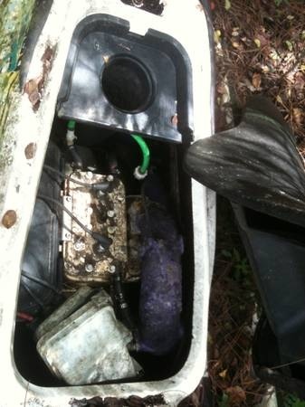

I'm new to this forum and I was planning on starting a thread to show my attempt at bringing a 1996 SPX back to life.
I bought the ski from someone on Craigslist. It has been sitting under a tree on the ground for two years. The previous owner said that the CDI box was fried after he tried to jump start the ski. He assured me that it was running great up to that point.
I'm no mechanic but I've always wanted to bring something back from the dead and I thought this might be a fun project.
Growing up our family had a n early 90's SPI and GTS. My family recently bought a 1991 GT and we had some much fun on it! It ran great the first 5 days we had it out but after that it wouldn't take off like it's supposed to and it would plane out but when you went full throttle it felt like a slipping clutch. So I guess I'll be doing a little work on that ski as well.
One thing at a time though, first in going to see if I can pump some new life into this SPX. It's really rough! Enjoy the pictures!
Any other threads or links to check out would be greatly appreciated! Thanks!

I've never gotten drunk and slept with a fat chick, but I imagine that the feeling I had this morning when I went outside and saw this ugly thing in my driveway has to be similar. So did I make a huge mistake? Has anyone else taken on something stupid like this before and been successful?
Actually that is not bad. Cosmetically it will clean up pretty easily. Pop the seat and let us see some pictures of the engine and hull
some purple power, simple green and a power washer will work wonders. Then buff and wax it. It will be easier to take the engine out and clean it from bottom up as well. Remove the gas tank and clean, replace fuel lines and tackle the electrical. Check on the pump oil and you might be good to go. Does not look that bad at all.

I'm afraid that I'm not as optimistic about this ski as others on this forum, and I'm not saying this to be harsh I'm just trying to be honest, personally I wouldn't have purchased this ski. I think it was Spim who said "you can't polish a turd". If a ski is this neglected cosmetically it has probably been neglected mechanically as well, after all how much trouble is it to throw a tarp over the ski.
Anyway before you put any time or money in this ski I would try to access the general mechanical condition of the ski. Remove the spark plugs, remove the PTO cover and see if the motor will turn over by hand, if you can get a battery or jump off of a non-running vehicle, attach the neg. lead to motor ground and the post to the solenoid, and see if you can get a compression reading, less than 120psi you will need an engine rebuild.
