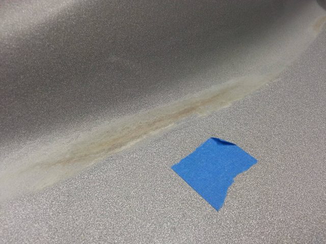

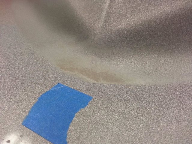

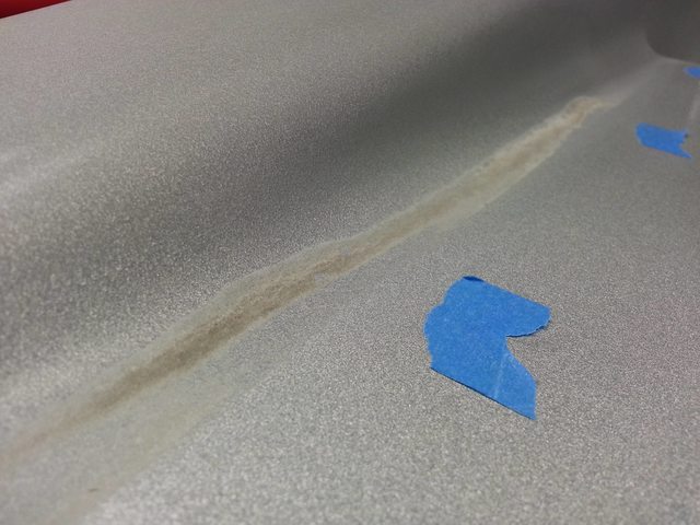

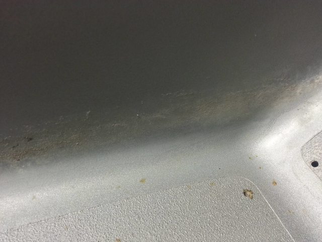

I'm relatively sure that's what this stuff is. Previous owner left them outside all the time so a lot of water and junk collected in the footwells and under the old mats. The stuff left behind is really hard and rough, and I can't get it off to save my life.
In the footwell
Along the left edge of the old back deck pad
At the back directly down from the grab handle
Another example
I've scrubbed away at them with Simple Green and a blue Scotchbrite pad, tried some 0000 steel wool with vinegar, and also tried CLR Lime Away gel toilet bowl cleaner stuff with a stuff nylon brush. Nothing really helped, except the CLR which was marginally successful. Any ideas?

Hey, I hadn't tried that since I didn't have any fine-grit paper laying around, I got some this weekend and tried it on those stains and it seemed to do the trick. Now the whole thing needs to be sanded so that's an ongoing project. :)
good to hear,,, like I said before, wet sand was always last on my list, and it has gradually worked its way up, because it works !!! and if the stuff gets softened up a bit, its even more effective.
