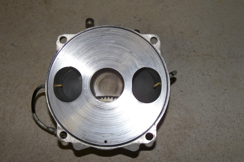

Turns out I had a thrust washer go out. Here is a picture of my rotary valve cover, does it need replacing or can I get by with just sanding it down?
A lot of them look like this, save the metal shims under the mounts and place them back in when you get the motor back inside, as others said it is a lot easier and very little extra time to remove the pump, it may be time to inspect the inner working of the pump anyway.
Thanks for the information. I have the engine out. I did end up removing the pump. Got to try and rent a fly wheel puller so I can get the fly wheel off.
