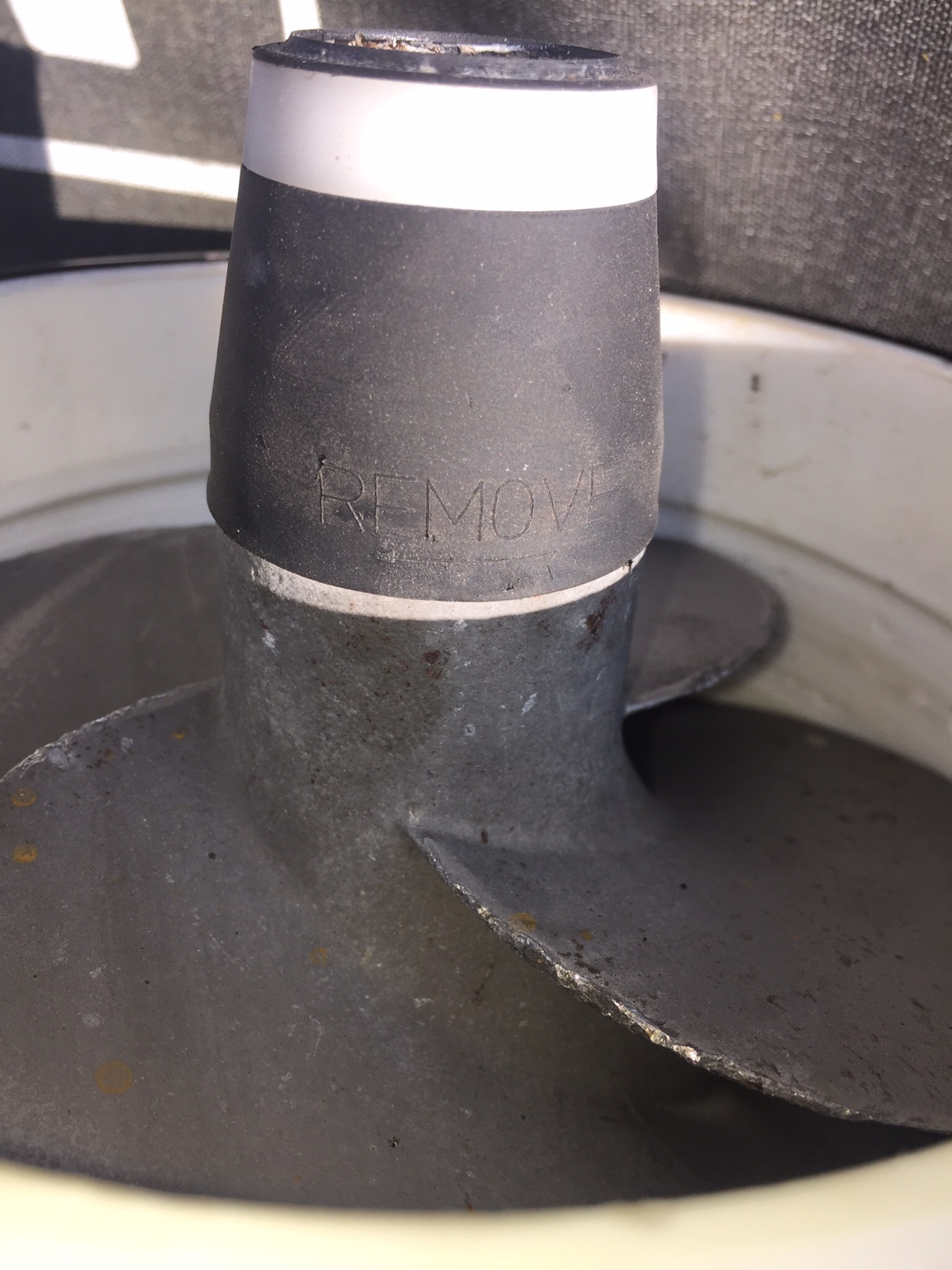

Helping a friend replace prop and wear ring on his 4 tec gtx. Is the prop reverse threaded on? I've never worked on a four stroke before and I'm not sure. On the prop itself it has an arrow that shows it reversed just wanted to make sure
That rubber nose cone unscrews from the impeller and is left hand thread. The impeller itself is right hand thread.
Chester
The Seadoo manual says reverse threaded and different forums are saying different things. This is concerning. How do you unscrew the rubber?
Just by hand, hold the impeller and turn the nose cone clockwise to remove. The impeller is definitely not reverse thread.
Chester
You guys were exactly right. Thanks for the help! New wear ring and prop are in. I froze the ring and it slid right in.
