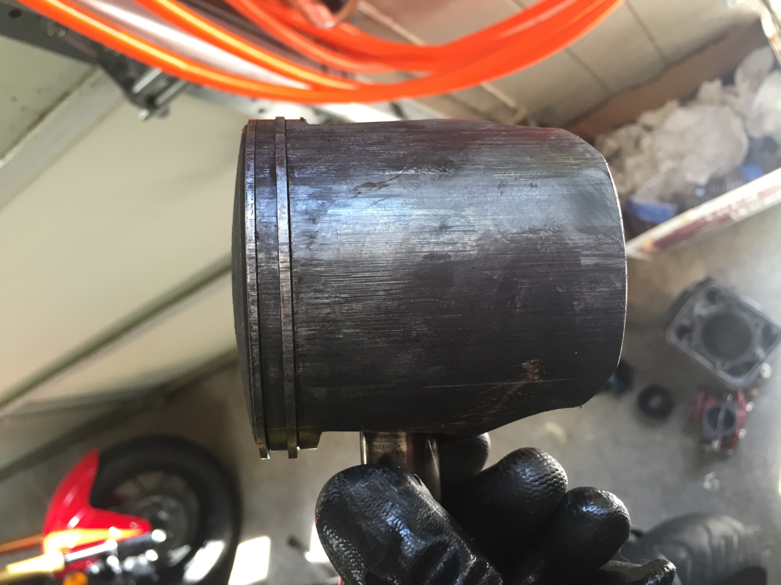

Pulled head, still has no pitting, top of piston looks fine with no pitting or ringland damage but the piston skirt on exhaust side has even worse vertical scoring than the last time I lost compression at the lake meet. Walls have some vertical scoring but not super bad.
What concerns me is that there is this gray oily almost watery substance all over the cylinder walls piston skirts and combustion chamber. Is water entering combustion chamber via the head o-rings? I didn't change as they looked ok.

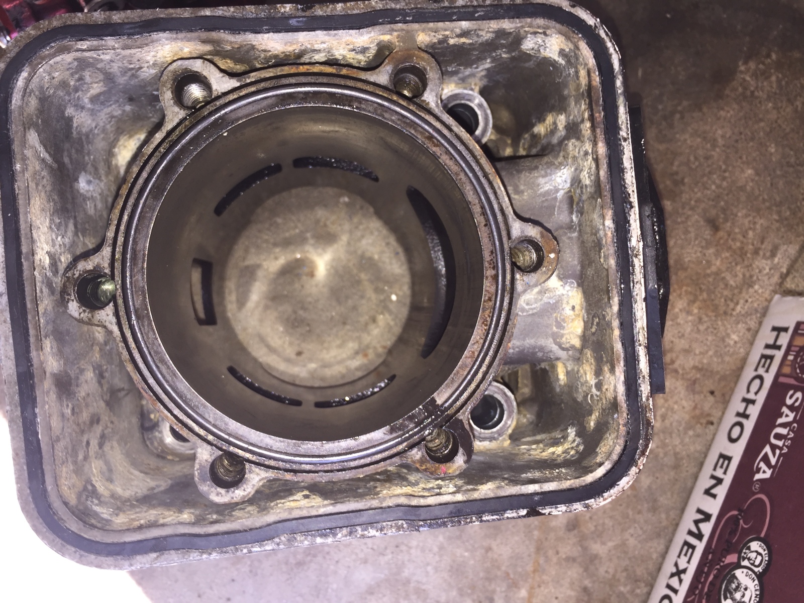

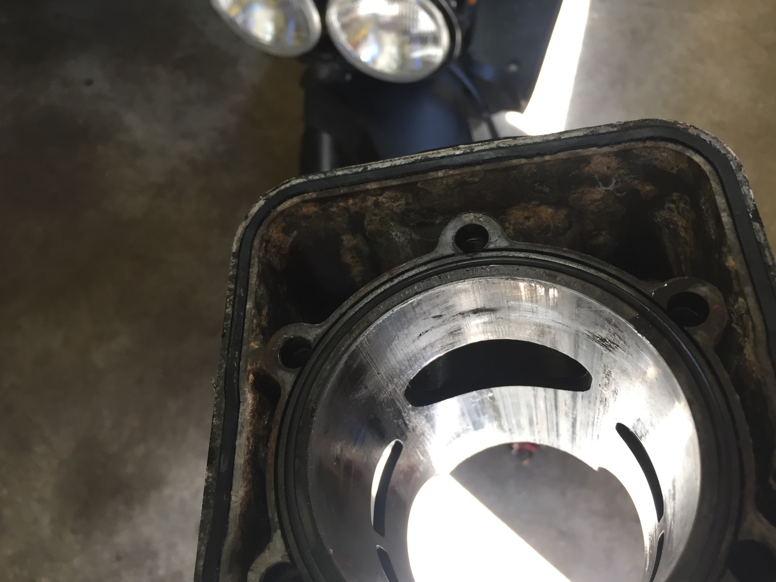

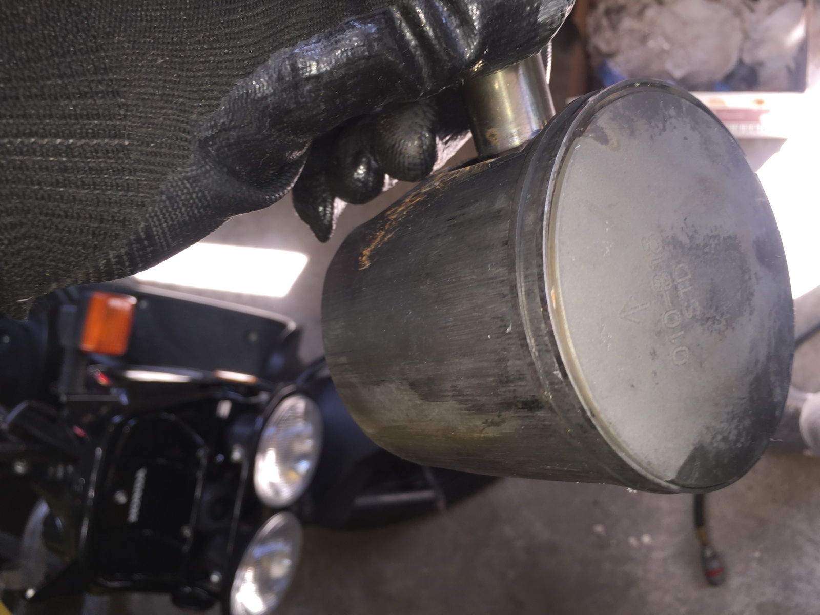

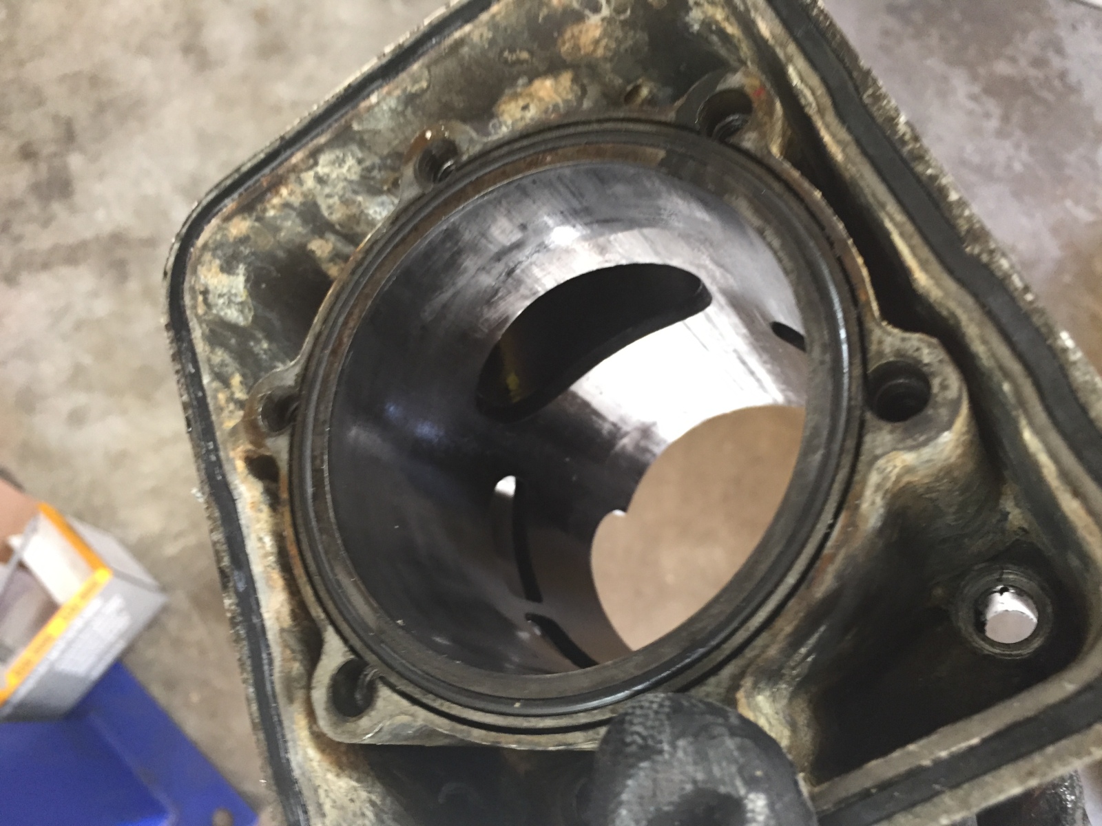

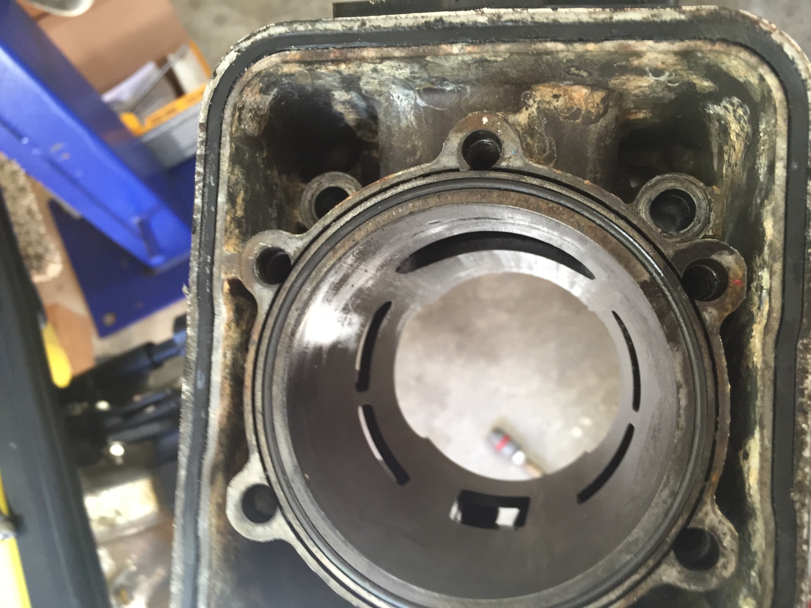

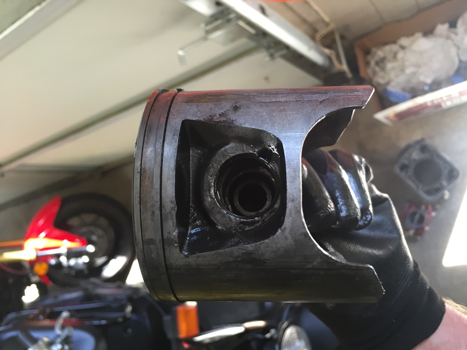

Previous symptom: Lost compression in PTO cylinder at the lake Norman meet. Found cylinder and piston skirt vertical scoring only on exhaust side of piston. Lots of gray dust on spark plug and cylinder walls and combustion chamber. 130 psi on comp test.
Repair a few weeks ago: new STD. bore pto piston, rings, and hone of cylinder netted me 148 psi on pto cylinder after break in. Replaced base gasket, carb gaskets and exhaust manifold to jugs gasket. All torqued to factory specs.
What's up guys I got my ski back together two weekends ago and put 5 to 6 hours on it and got it all broken in.
148 psi on the PTO cylinder afternoon rings and new piston and honing of cylinder stock bore. Have been on multiple trips to lake and it runs great spark plugs match in color, although both kinda rich I felt it was still on the premix in fuel tank for break in. ( ski still has factory oil inj)
Went to ride it yesterday rode for an hour or so. Still curious why only getting 6600 rpms max I put a fresh set of spark plugs and it got about a mile from the dock in and just shuts off during wot run for a few secs. Clunks during try to restart. Waited 15 secs starts right back up doesn't have a lot of power stops around 5000 RPM nursed it back to the dock check the plugs they don't match at all now rear plug his gray.
I got home, still have great 164 psi in front cyl but rear pto is low again at 134 :-/
I did rebuild the carbs with oem mikuni parts pop off at 35-36 psi per carb and bleed down psi check passes. All set to factory specs, proper jet sizes, 1.5 needle and seat replaced new gaskets diaphragms.
I'm almost leaning towards water into cylinder being my issue. What do you guys think? Pics coming I'm in garage now.
Thanks!
Rob
