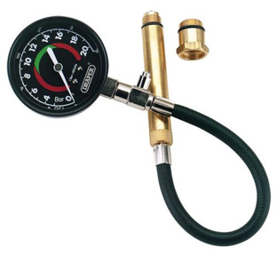

:coolgleam: Compression guages can be found at most auto part stores, hardware stores, ebay and other internet sites.
