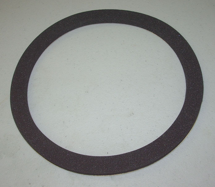

I have the carbon seal on my Speedster and no cavitation. I notice that you don't have the neoprene seal on the pump mounting plate. Also if it hasn't been done yet, the seams on the plate should be siliconed up where the black pump shoe meets the white gel-coat. I also did a guys Challenger in the spring and rebuilt the carbon seals with a heavy duty stainless ring, new wear rings, Solas Concord impellers and neoprene seal and that is a pretty heavy boat and there is zero cavitation on that , the holeshot is awesome. If you seal up the pump correctly there is no need for the old bearing set up.
Neoprene seal 293200024

Neoprene seal installed
Sweet thanks for the reply, I thought there was something missing- every other pump I've ever pulled had the rubber ring.
Not sure if ill get the HD SS collars initially but I'll definitely get the neoprene and flush up the gaps.
