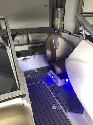

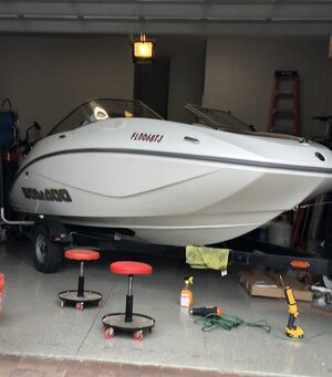

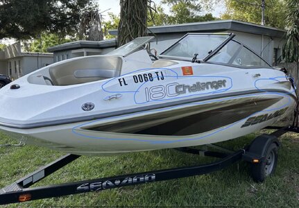

Was able to find a 2007 Sea Doo Challenger 180, the boat and seats are all original
not modified or molested. Just looking to make a nice sand bar island hopper boat
for me and the wife. No real maintenance records, can tell the super charger has
been removed due to aftermarket hose clamps .Going to post my progress with updates

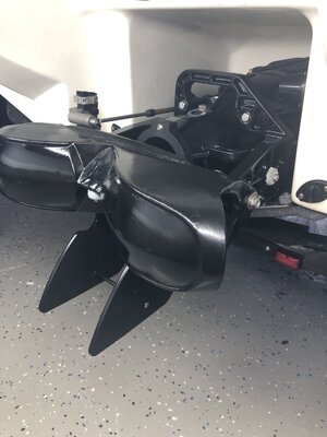

to this post. So far changed the plugs and the oil and added Thrust Vector fins. Working
on removing the old decals and have ordered new jet pump, impeller , carbon seal kit,
and will send out the super charger to be rebuilt. I also have added swim platform mats.
I hope to read and learn from this site.

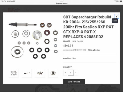

Thanks for your reply, removing the super charger hose is where I spotted the
aftermarket clamps. Can’t spin the turbo but while I am doing the drive line
just want piece of mind so going to have that new 200 hour rebuild kit installed.
I understand not to go to 200 hours but it is a good complete kit.
Also your project is looking good.
I sent my Turbo out to be rebuilt with that kit. Got the whole thing done for ~450 kit included. I used GreenHulk. I got his reco from the CANDoo forum.

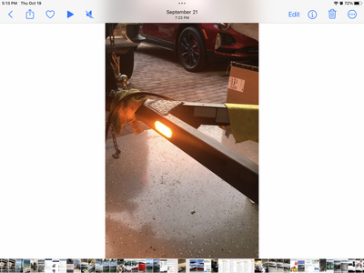

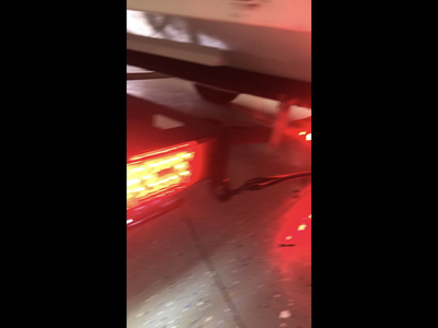

Thanks for the tip. Still waiting for SBT to deliver all my drive line parts. So decided to go a head
and give the trailer some love. It is in good shape but all from 2007 ,installed all new LED lights so much better,
Trailer guides ( wife pulls the boat out of the water she can’t back up the truck) Then changed out the bias ply
tires for some radials and even had them balanced. We plan to take the boat several times to Key Largo.
This lead to ordering a complete axel bearing kit to finish the job. Project continues

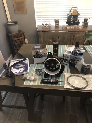

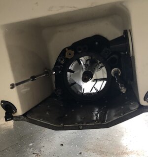

Time to get to work all of my drive line parts have arrived.
New boat owner jumping into the deep end Fingers crossed.

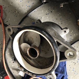

Wow, you went all out with a new pump housing as well. That's cheating, your supposed to complain, swear and get bloody knuckles over getting the wear ring out. :D

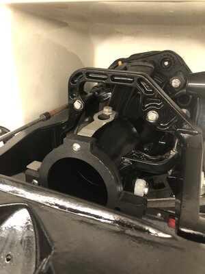

Well Sunday and this being my first boat, had a bolt strip holding the nozzle support
to the pump so I tried to remove the pump as one part and the pump was corroded
to the drive shaft after some PV Blaster a hammer and a bad attitude was able to get it.
Then went to work on the striped frame bolt had success with a over sized Allen wrench
installed in my hammer drill and got it out. simple project turned into 4 hours.
The ware ring is gone and the impeller beat up. Purchased a new pump so I can
have the other as a back up and get a few more tools to be able to rebuild Myself.
went and painted all the parts and called it a day.This Saturday will remove the
carbon seal and boot and pull the drive shaft it may need to be replaced also.

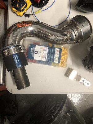

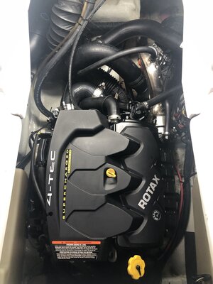

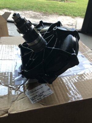

Making progress on the drive line, got the new PTO bearing and boot, new carbon seal kit
and new driveshaft installed also cleaned the engine compartment hull with degreaser.
Then last night installed the new pump ware ring and stainless steel impeller. Also the
supercharger is back from Green Hulk. cleaned out the J pipe and drilled the 3 holes
larger for better flow. Hope to have it all back together this weekend.

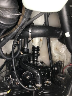

Finally finished installing the new drive line parts From the engine back.
Just need to install the rebuilt Supercharger, exhaust, and all the lines back
up and will be able to water test.

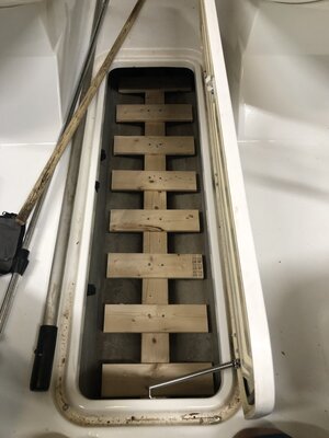

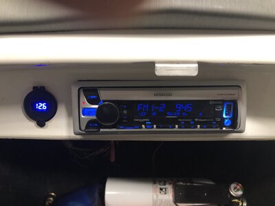

After work yesterday I installed the duel USB charger with Volt meter ,then built a rack for the
ski locker to keep my Bumpers and lines out of any water that may accumulate . When I purchased
the boat it Had wet slimy moldy old Bumpers and lines that went in the trash.

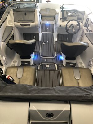

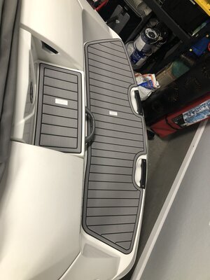

Went ahead and upgraded the courtesy lights to LED bulbs much better.
Then finally installing the rest of the Marine Mats I got at 40% off from
Jet Boat Pilots Oct Sale. Project is just about finished time to enjoy.

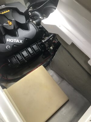

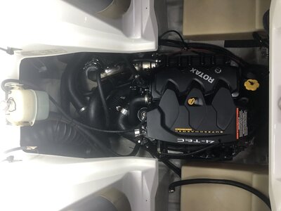

Only had it out a few times, I added some new
Speakers and really cleaned up the engine bay.
Honestly it’s looking like new now.

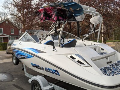

I'd like to piggyback on your thread, as I've got this same boat. It's a 2007 180 Challenger and the last few seasons it's been nothing but problems. The boat always starts and runs great cold, but once it's been running for an hour or so, and you turn it off, it won't start back up. It often needs to sit for an hour or more before it restarts. I've seen other people report similar issues, but have had no luck figuring out the cause.
The biggest issue is that it never throws a code, so we can't pinpoint which system is failing. My mechanic has done everything possible to the fuel system and that is operating fine. Our best guess is that it's a sensor of some sort, but we're not sure how to troubleshoot. I'm looking for any tips, suggestions, or a mechanic in the New England area who is familiar with this or similar issues. I love to spend some carefree days on the lake this summer and am tired of lugging around an emergency trolling motor. Please help!

Thanks for the compliments…on your boat have you replaced the water box temp sensor
And oil pressure sensor. I am a novice but have you cleaned or replaced your injector's.
I hope you get it figured out.
