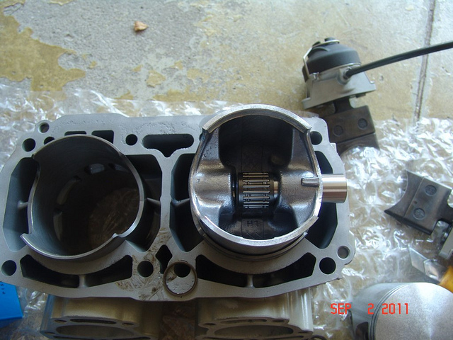

I have a set of wiesco's in the shop right now. They fit the same way. It seems horribly wrong. Keeping the rod centered & sliding the bearing to one side, there is so much side movement it exposes the needle bearings some. That seems crazy.
EDIT: Scratch that, I had a brain fart & checked the bearing in an oem piston. In the wiesco & WSM they have less clearance in the center of the casting, so the bearing stays centered, & no need for the thrust washers. Sorry..... All is good.
