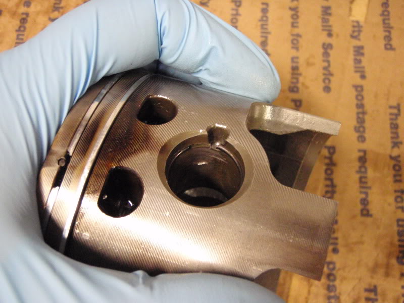

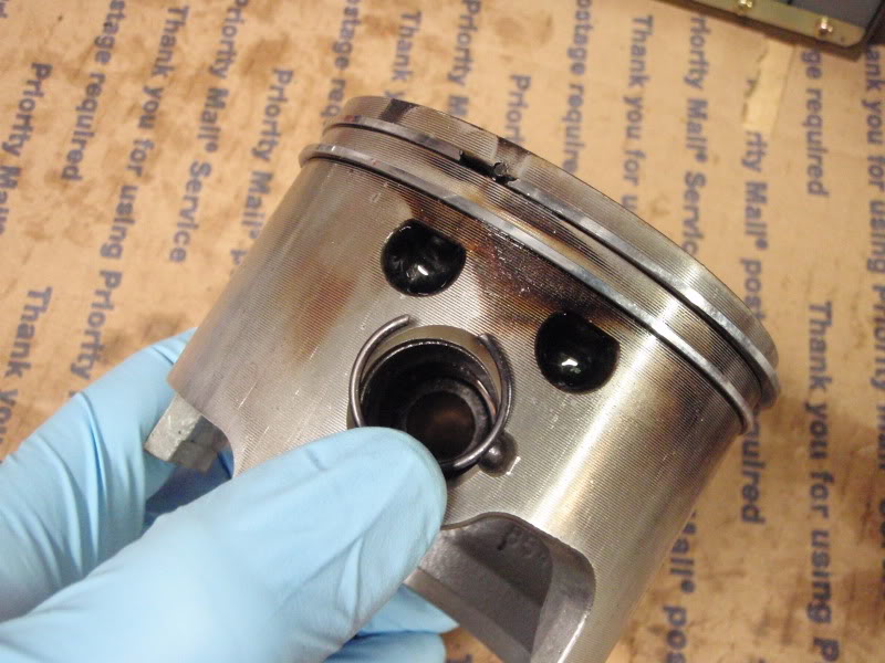

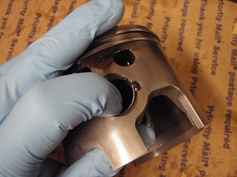

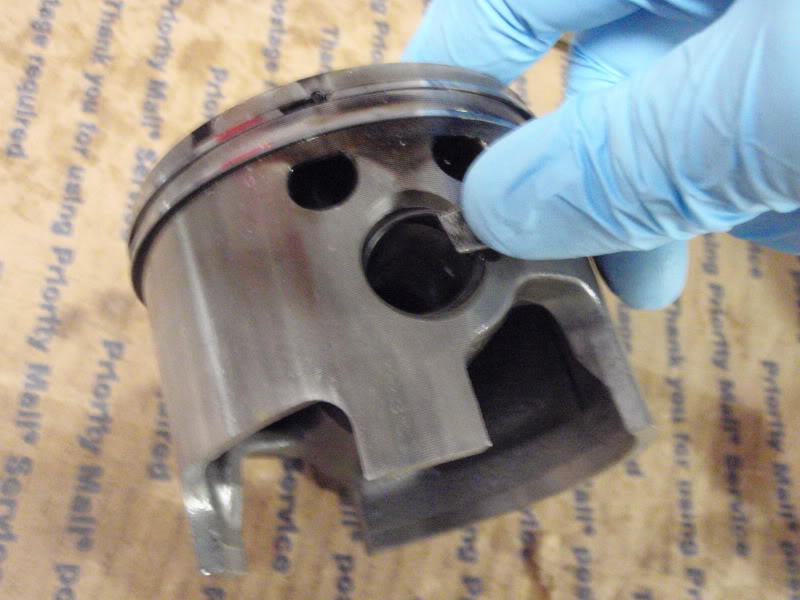

Piston circlips
Depends what pistons. OEM style, have a little "hook" on one side that co-insides with a notch in the circlip grove. Those are a great pain the the A$$.
But I've found the best way on any engine is to put one end in the grove then hold the other end with a paid of needle nose pliers. And twist it and get the other end in the grove. Sort of the opposite of putting rings on a piston. You don't want to compress the clip too much to distort it. Then use a small DULL flat screw driver and pop the rest of the clip into place. Then my next step is to take a punch, and gently tap the wrist pin from the opposite side against that circlip. That will make sure it seats. Be sure to put a rag over the piston before doing so, in case it comes out. Or invest in a circlip installer. Never used one, but i'd imagine it would be easier.
As a rule of thumb, the opening of the circlip should face down, unless instructed otherwise. Hope this helps
All of them are a pain... but not impossible.
Just get an edge in... and push it down with the flat end of a screwdriver. if you have an old piston... practicing a couple times will make it easier.
I find it easier to push the rear, center down in... and then snap the 2 tips in with a flat screwdriver.
What they^ said , i drape an oily rag over the job when doing things like this and work under it ,if you see what i mean, so that if the clip pings off it doesnt fly away and never be found.
