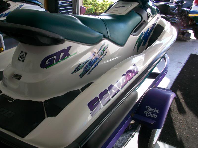

Took it out today...what a great ski!! I think its needs some very minor tuning on the carbs...but other than that, everything works great...even all the gauges. Every single inch of it is almost perfect. :cheers:

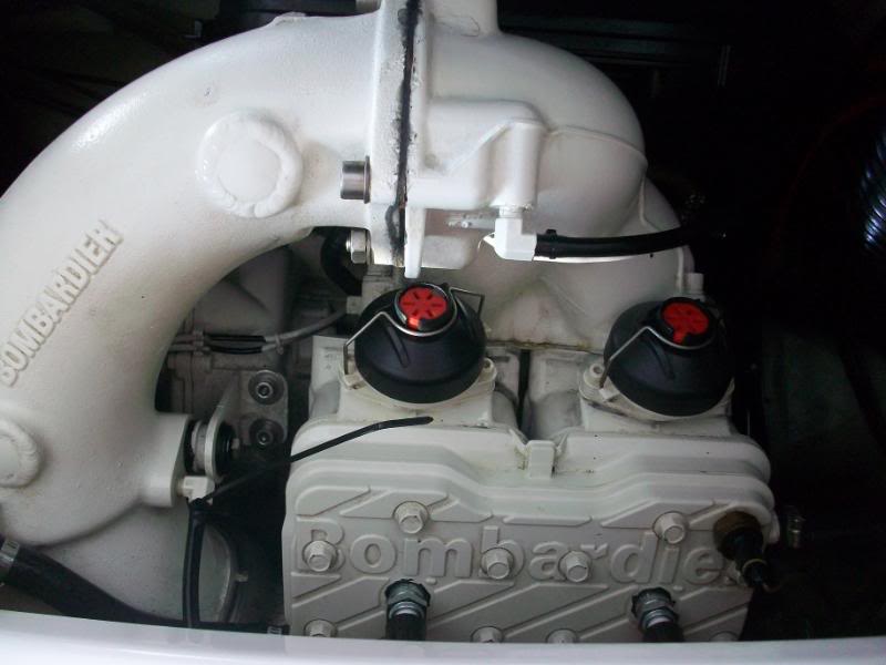

Well we took it out Sunday. Everything went great, except on the way back from the island...I crused out about 53 and about half way back it would not go over 40...I think I may have gotten into some seagrass though...when I got back to the boat ramp and shut it off there was lots of grass floating out from underneith the ski. I reached under it to clear out the great but there was not much in there. I think it came out when I shut it off. I did not have time to go back out to see if that was the issue. The only other thing I noticed was about mid throttle and cruising, the rpms seem to fluxuate...feel almost like I give it a little more throttle on and off....other than that everything is great and I'm soooo excited I finally got my GTX!!! :cheers:
Quick update....Took it out Friday..Def needs a wear ring, and somthing is up at wide open throttle cruising...RPM's drop about 1,000 then back up...almost consitant...Starts up very easy, and when you mash the throttle it does not hesitate or anything.
...The only other thing I noticed was about mid throttle and cruising, the rpms seem to fluxuate...feel almost like I give it a little more throttle on and off....other than that everything is great and I'm soooo excited I finally got my GTX!!! :cheers:
Are you sure that wasn't the RAVE valve's opening up?
If you ride the throttle in just the right place the rave valves will open and shut, it's kind of weird at first.
Speaking of RAVE valves, make sure you take them apart and inspect/clean them before too long, since you don't when it was done last, they could be in need of service.

Thanks for the info..do you have a linky on how to do those?
It's pretty simple. Do you have the operators guide & service manual for your ski?
Also check out http://www.seadooforum.com/showthread.php?t=33247 for some basic information about cleaning RAVE valves.
You can also do a google search and find alot of information.
The basics is to remove the RAVE valves, clean the carbon off, inspect the bellows to make sure there are no holes/wear, and reassemble.
-TheChad
Here's a post from kustomkarl on RAVE Valves...
kustomkarl said:
Here is some information to the annual cleaning of the RAVE valve;
The RAVE, (Rotax Adjustable Variable Exhaust) valves are located above the exhaust valve. There are 2 of them per engine. They are round with a red adjustment screw in the middle. It has a clip that holds it together. How they work is that they open the exhaust port larger as the engine rpm's increase. When the rpm's drop down so do the RAVE valves. They work on the principle of the pressure of the exhaust system. Rpm's increase, pressure increases and the valve opens, rpm's drop pressure drops, Valve closes. They should be de-carbonized annual. To disassemble the rave valves, remove the spring clip on top, remove the black cover. There is a spring under the cover. Remove the piston by turning it with a metric socket. On the bottom of the piston is the rubber "Bellows" be careful with the small retaining spring that hold the bellows on the piston. Remove the 2 allen screws that hold the base on the cylinder. Remove the base and gasket. The long valve won't fall in the cylinder just pull it out. There is an o ring under the base, on the shaft of the guillotine valve. Be careful to see how it came apart as it has to go back together that same way again. On the base, notice the notch that it is facing down. Clean all the carbon off the guillotine valve. I use carb cleaner and 400 grit paper. Check the bellows for any small pin holes. If so replace it. If not, reassemble it on the clean guillotine valve, and install it back on the engine the same way it came apart. The guillotine valve only fits one way. The one closest to the exhaust pipe will come off differently then the other one. You will have to remove the allen screws and turn the base so it clears the exhaust pipe. I would do one at a time in case you forget how it goes back together again. This way you can look at the other one and copy it. Do both engines 2 per engine. Take your time and if you have questions give us a shout. We'll be here to help you out.
If the RAVE valves are dirty it will not rev up correctly and could be causing your problem.
The adjustment knob (the red cap) should either be screwed all the way in or flush to the top of the black ring of the cap. This will only affect performance, as far as how it jumps out of the hole or how well it runs for extended periods at WOT.

Mine is rubber. I might take it out today. I cleaned the valves, and I replaced the gasket from the manifold to the mid pipe.

By the way, I'm pretty sure it's the RAVE valves causing that. I have the
same seadoo, The first one seems to have this issue often so I have
to keep an eye on them. The 2nd one I have seems to go longer without
an issue.
