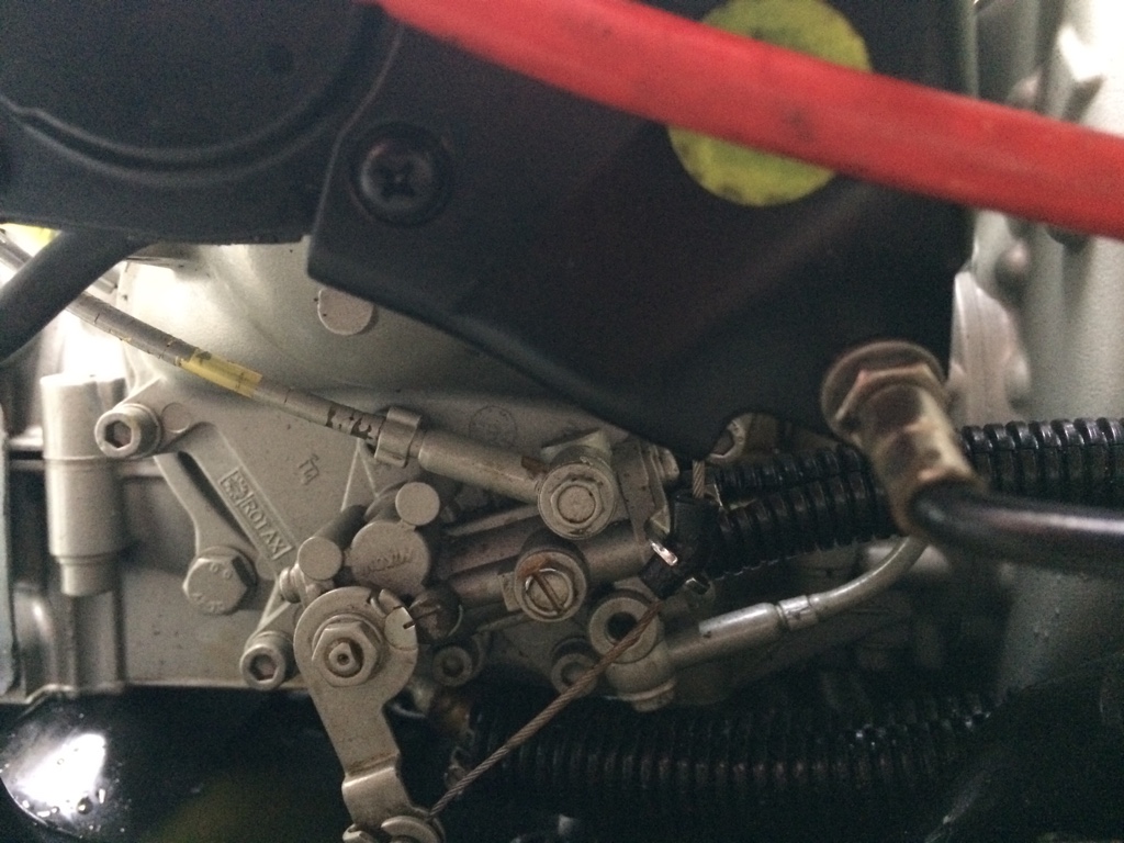

I found the old wire guide on the bottom of the hull and it looked like it had been broken for a little while. i figure the guide snapped and the wire just sat in the bracket for a while. If that was the case then the oil pump control lever notch wouldn't have lined up with the pump and could have been the reason for the mild smoking when warm too.

Will the oil pump control lever need to be readjusted after it has been ran or am I good to go?
Should be good to go. Work the throttle back and forth some and eyeball the alignment mark one last time and you should be able to enjoy reasonable oil consumption. Very very soon I will be putting oil injection back on my boat. I used 8 gallons of oil this year premixing and that sucks :cheers:
