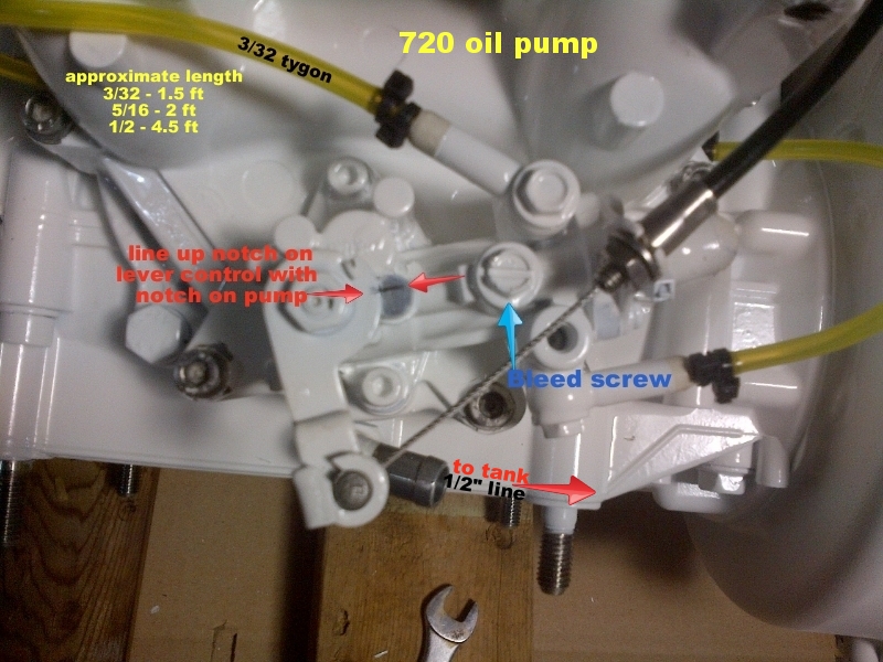

This image is from the 1996 service manual, section on 717 (720) engine oil pump adjustment.
I made some notes, and the rubber oil lines that should be replaced if not yet done are in orange.
As the throttle is moved, this cable also moves the lever on the pump. Set the throttle to idle position, the indexed marks on the pump and lever should be aligned parallel (red line). It the lever mark is left of the pump mark, this will produce more oil (It's been a while since I've worked on a 720). So you can see, as the throttle is increased, this rotates the oil pump control lever CCW and adds more oil volume, accordingly.

Check injection pump adjustment of both engines, throttle lever in idle position.

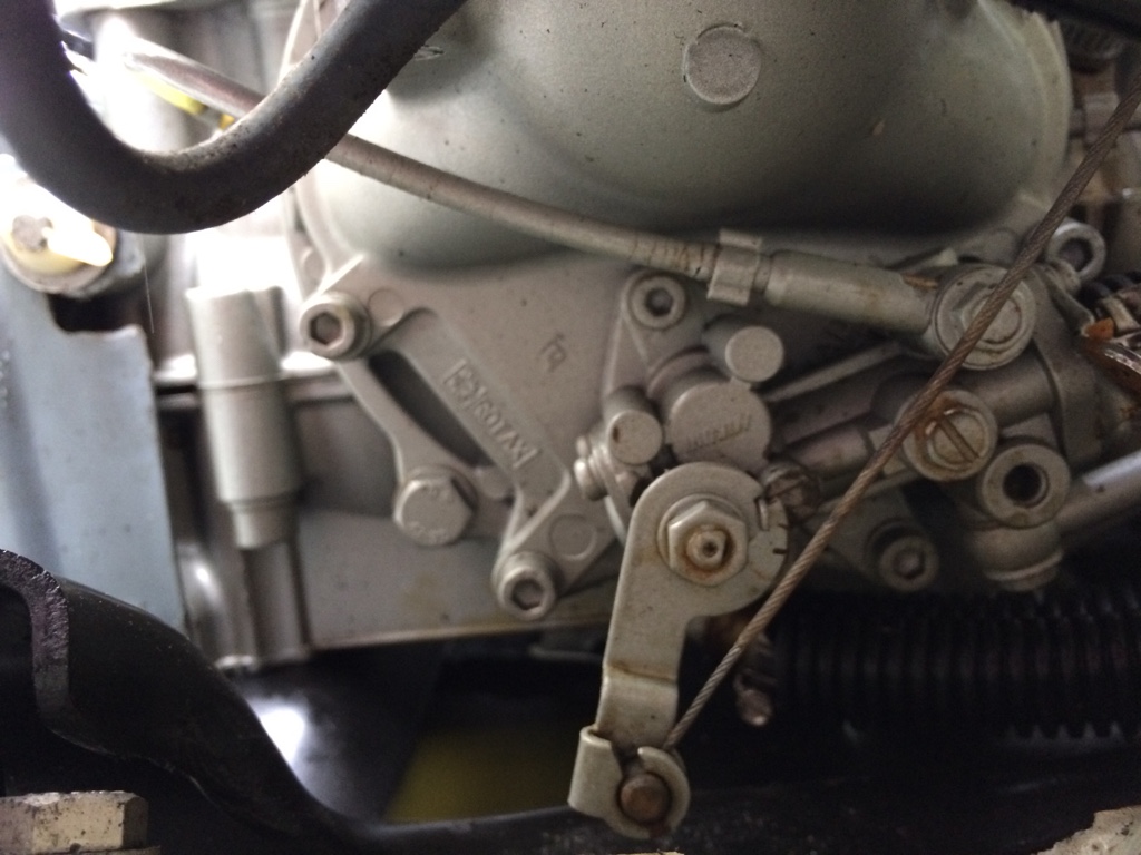

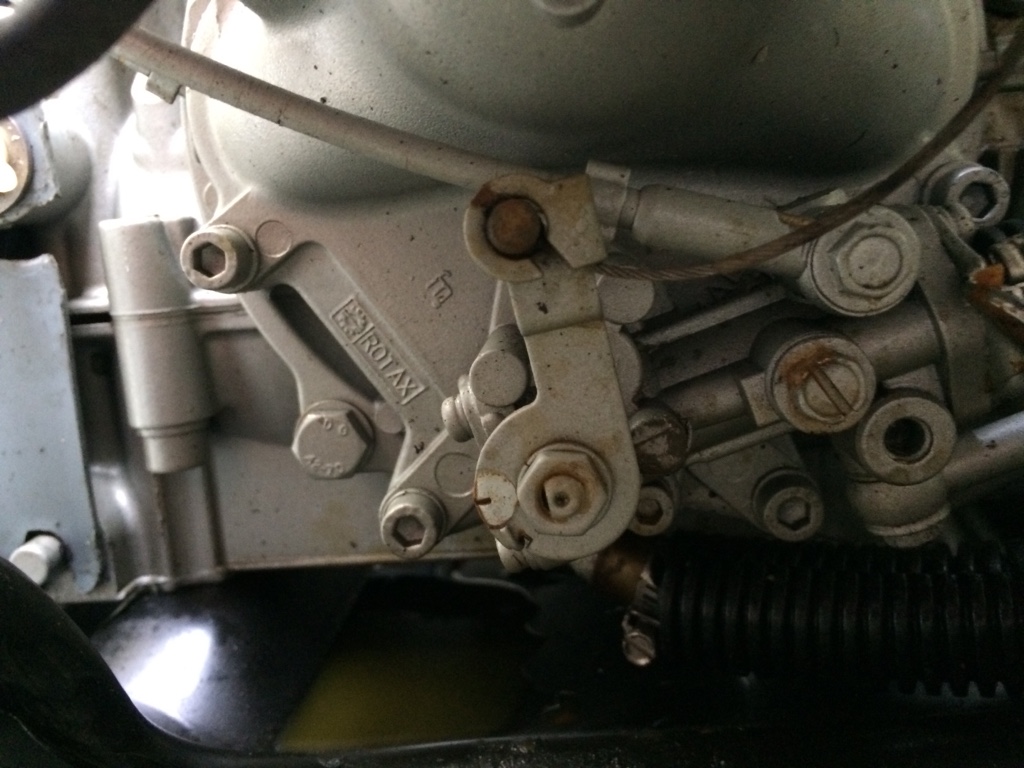

Here is what I found and yep... its weird!
The oil pump control lever was upside down and the cable was very loose. So I assume it was dumping oil as if it was at full throttle.
I just turned it with my hand and the cable went tight and it's sitting down where it should be. "Still needs to be adjusted so the notch lines up"

Not sure if it would make a difference, but I noticed that the cable is not routed through the change of direction bend that is shown in the diagram just to the right of the upper banjo bolt. Maybe this is putting stress on the cable and pulling it at the wrong angle or allowing it to pull all the way up?
Its a little different setup then this but all these pictures help. On the speedster SK the oil injection cable comes from the control lever to a bracket under the carbs. Having two engine side by side has helped. The bracket is missing the cable guide in the picture Sportster-2001 added
Squad1... Good eyes! That is the only difference between both of my engines oil systems. One is missing the cable guild. i sprayed a little lube on the slot in the bracket where the guide should be and hold the cable in the slot while my daughter worked the throttle. The pump lever works perfect!:thumbsup:
