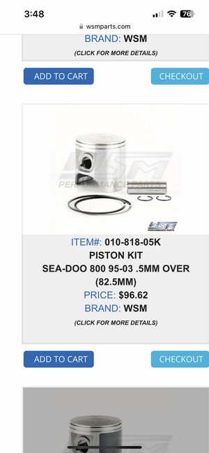

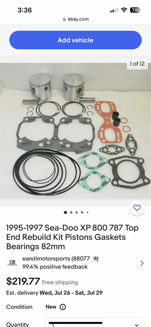

Would these be the right ones? One is 82 mm and the other 82.5 mmmYes but I can’t find the right size pistons.
Thank you for the info. I’m new to the whole rebuild aspect and the terms, would boreing out the cylinders be something I could do?The 82.5 will work, it’s the second size over, but you will have to have the guillotines on the rave valves trimmed back With these. Buy your pistons first and then take the pistons to your machine shop before they bore out the cylinders. I seen 1st over (.25mm) pistons for sale at Partzilla.
Also just to throw out there i orders pistons that were 1MM over and they were to big.WSM - 010-818-04K - Piston Kit (786cc), 0.25mm Oversize to 82.25mm Bore for sale online | eBay
Here is a set for .25mm over
