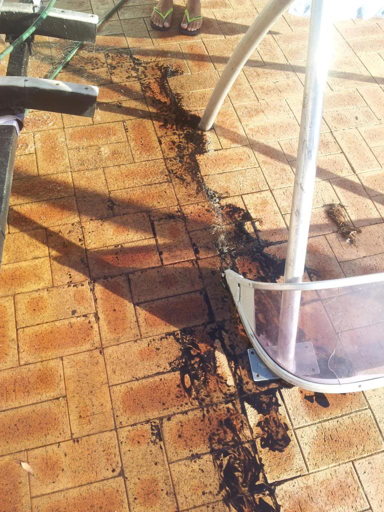

All kinds of crap comes out of our exhaust systems all the time. We need to get you rich so you can work your self back to the proper mixture. After that there are still instructions on water tuning that pipe. For now I'm still scared of this talk of white plugs. Right underneath white plugs are white pistons that want to be chocolate brown.

Ok so this is what the black stuff that came out of the exhaust looked like.... the water is tap water so i could wash it away and it would not stain the paving...

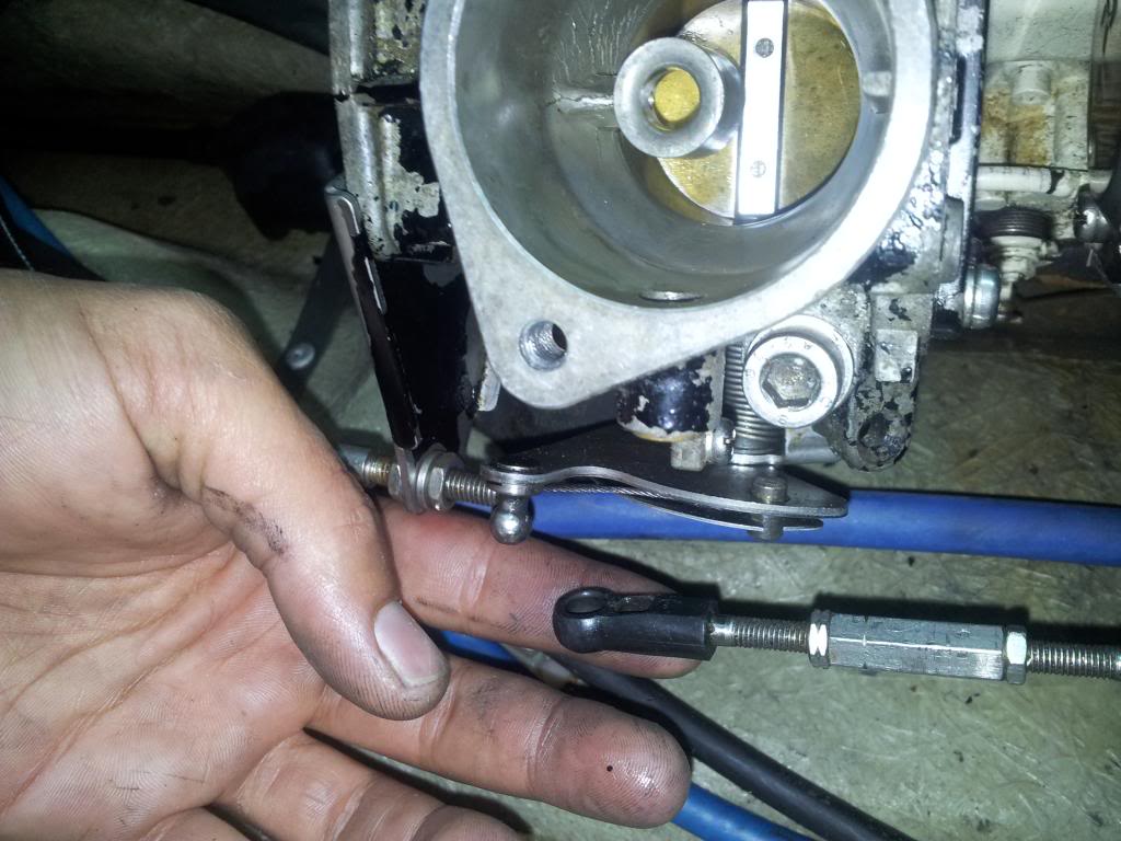

I may have found a problem....
So i pulled the two carbs off, I had a problem with the little plastic flap before that stayed up and not flush with the moon shape block(sry not sure whats its called) Anyway it was flat and it all looked ok. so i put it all back together.
Now when i bolted it to the manifold i realised that the link bar was too short and that it caused the back cyl to open. Is that normal? I also noticed the back doesn't have a stop screw, only the front one has one.
So is this normal or should i extend it?
Thx
The engine racing up on you could have definitely been from the carbs needing to be synched. I would adjust the rod so they open and close together.
