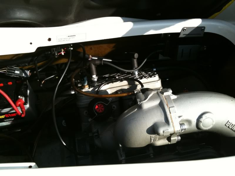

Does it have the gray fuel lines in it sounds like what my ski was doin timings the gray fuel lines cleaned fuel selector and runs Like a champ
I did compression check its at 140psi across the board :\ ... i mean the ski idles good specially out of water... and when it comes to the fuel lines i'm not sure if it has grey fuel lines lol but here's the pic
Did you see Minnetonka's response? If it runs good sitting on a trailer but not in the water the angle change could be causing the pickup to grab from a layer of water in the tank.
Seems like good compression; fuel line issue does NOT pertain to RFIs.
Reading other responses I would prob. pull off the intake manifold and see if there is that grey stuff and clean it up. Dont unhook the throttle or anything, just take the aircleaner off, then the 4 bolts that hold the mani on. Make sure the rotory valve stays on the motor so the timing stays correct.
