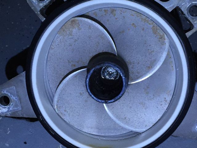

Ok, being fair, this is off my 2009 RXT-X, 255 that I purchased new untitled in November of 2011.
I pulled the pumps off my skis to put in new synthetic grease and do a good inspection.. Both are in great shape. Just wanted to post that these rings CAN last for years,,, just depends on what you get into the pump area. On this pump, I have had two twigs and some seaweed.
That's impressive and the prop looks good to, unlike me you probably never sucked up rocks either, rocks are the killer on these skis as I found out the hard way.
Nope, no rocks.. I do beach the ski's, but do so gently. When I take them off the beach, I do the stern up and down thing to flush out the tunnel.
In my neck of the water, you have to worry about rocks, brackish water oyster shells and sand in addition to mostly saltwater riding and all that entails. So this is impressive to me. I think I'll be lucky to get 4 years out of my wear ring even with my cautiousness. I only start up in waist deep water after pushing it out, I'm 6'2", and climb on the back of the ski. Yet I've already had one instance where I was in shallow water and didn't know it until I saw the crap being expelled by the Jet. I've also had multiple instances of pine needles being caught up in the grate/impeller after coming back from riding. My ski still does 66mph (limited by GPS), 65mph even on slightly rough water, so I'm good for now.
The best way to tell premature wear of the wear ring is seeing a drop in top end speed on flat water while seeing RPM's increase without a corresponding increase in speed/"pull". If you feel high speed vibrations with a drop in top end speed, but the ski accelerates as usual, you've damaged your impeller, which typically includes damage to your wear ring.

How often should these be replaced? Is there a certain time frame? Or just when the gap gets too big?
Only when needed. There are no time frames. When they get damaged and or wear out.
