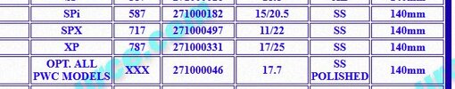

Looking at an impeller (I have the 15/20.5 Pitch SS) that is optional for my year but not sure the impact it will have re top speed increase and performance as the pitch is one number instead of two(17.7).
Its the optional one in this snip of the chart, if anyone has knowledge and can chime in please do so.
17.7 would be a straight pitch which is kind of old school now days. Pretty much everything went to progressive pitch in the mid 90's because you get good bottom end and top end instead of one good spot like a single pitch.
Seadoo pretty much did the best at picking stock impellers out of all the manufacturers so there is very little to gain changing the OEM impellers. My suspicion is that they had Skat-Trak make them which is still the best in the business.
