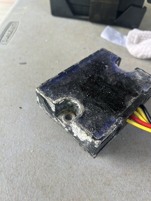

I couldn’t find a way to test the rectifier without starting the pwc. However I did locate my rectifier and it definitely needs to be replaced. I appreciate your input!
