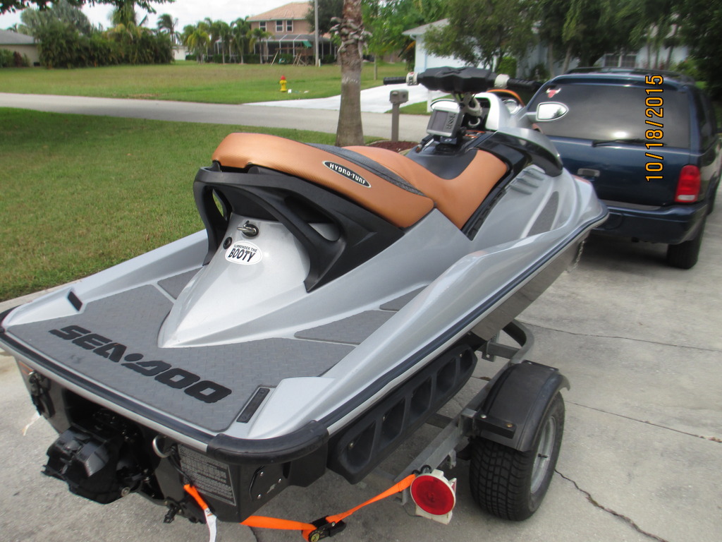

FWIW, I don't know what size you have now, so maybe the following is worthless but:
these are the tires on my single trailer. 205/65/10 $99 each (even cheapos were $45 when I last looked so it was only $100 extra)
made a noticeable difference in look and feel, tows like a dream, IMO if your going to upgrade, explore if your fenders would allow you to get some fatty's. Its worth it for any long distance regular. I bought this trailer just before last years 10 hour drive to georgia, big difference on some of those crappy back roads and I feel better when rolling over railroad tracks and such.
if you were a 6 miles to the ramp guy i'd just suggest a cheap set anywhere but for long trip reliability you want great tires and a spare, replace springs when applicable & hardware if needed and your set for the next few years.
