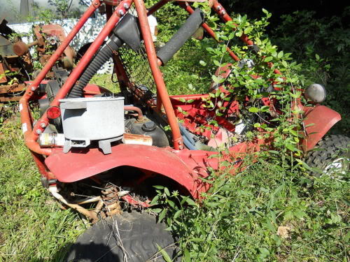

Here are a couple photos of it so you can see what i am working on. The first picture is what it looked like when i bought it on ebay. Had it shipped from Alabama to Washington. It sat where you see it for 10 years or more. the second picture is a work in progress, hoping to get it running better before i put all of my fenders and final touches on.
