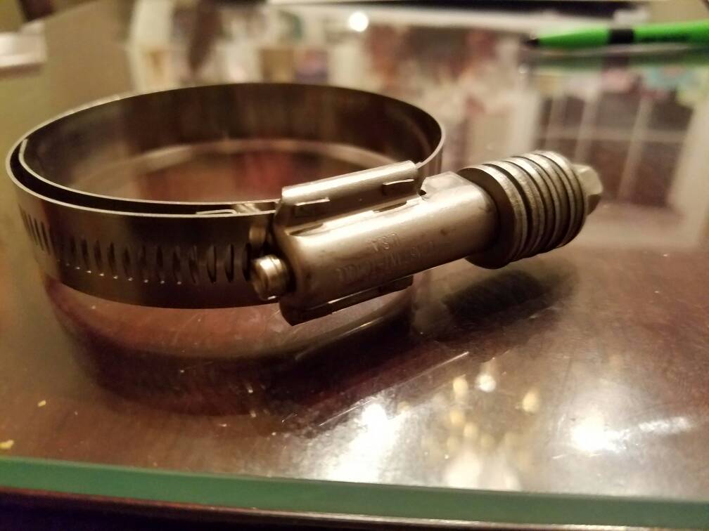

Just curious where any you purchase your marine grade stainless steel clamps for your Seadoo.
eBay or Amazon, search 2 1/2" heavy duty stainless hose clamps. I ordered from MAPerformance got 4 tbolts for $12.00
I just picked these up I really like them
