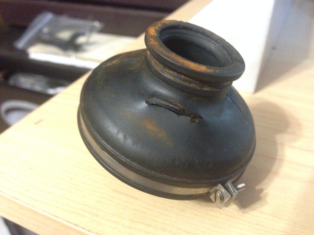

Yes the upper clamp rusts but not as bad as the lower clamp which is actually the one that punctures the underside of the bellow like what is being pictured above, use a small zip tie on the bottom in place of the metal clamp.
