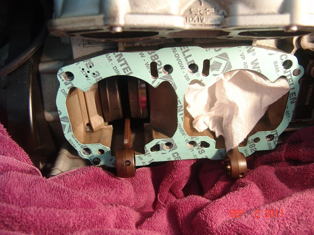

my 951 di gasket has 5 small holes in one corner. does this go to the pto or mag side?
thanks you guys have been very helpful
top left corner , pto side or do I need to flip it to the mag side.....I forget and didn't get a pick when I took it off
DSC04983 by docdrs, on Flickr
yes... it .5mm
BUT... the gasket only fits one way because of the guide pins. (it's not symmetrical)
yes... it .5mm
boy do I feel stupid, guess I was too caught up in how am I going to get the jugs over the pistons to realize that there is only one way for the gasket to go on......thanks dochonda for not making fun off me......i do deserve it just slap me in the forehead
