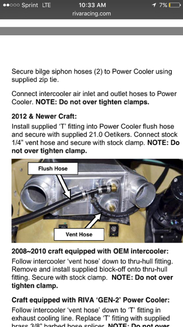

Hey guys just got my new riva gen 3 intercooler. For my 2013 rxt-x. Has anybody installed one yet on the RXT or have any pictures available thanks guys

I sorry I didn't. I ordered directly from riva cause I called about the vent hose that I have already on the oem one that flushes out the transom. and there flush hose that comes on the riva IC. Wasn't sure on the hook up with that. Still little concerned. That's why was asking for people pics
The flush hose just lays in there?? Can't see the rest of it. Pic cuts it off. And the vent hose goes to the oem transom
