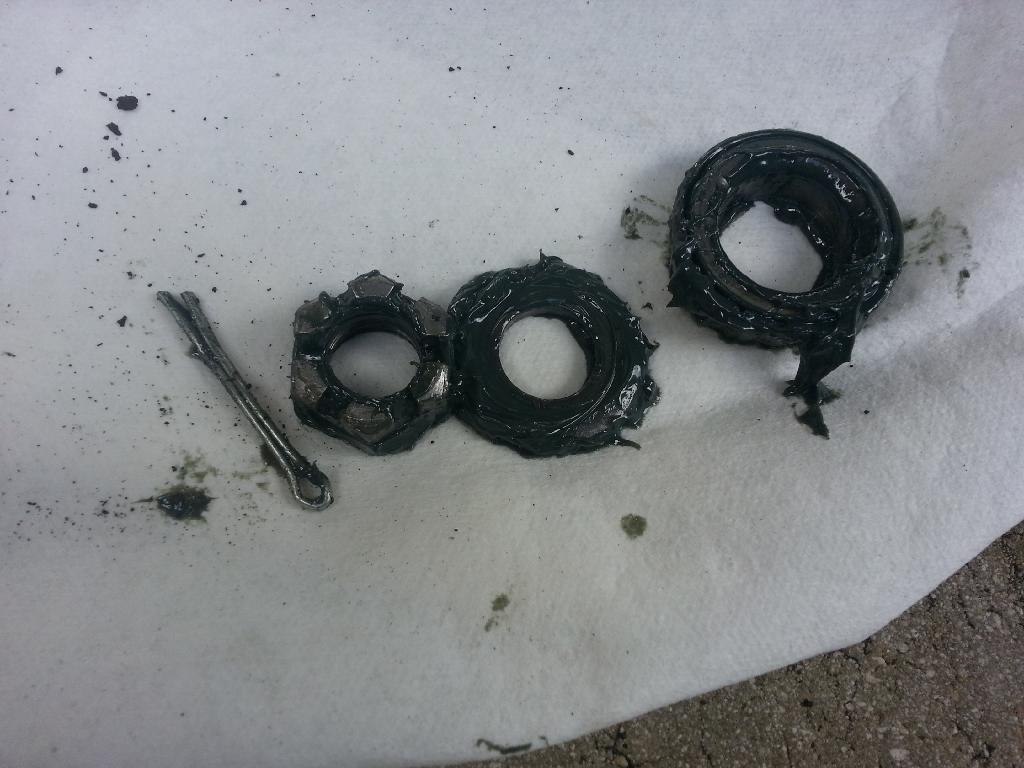

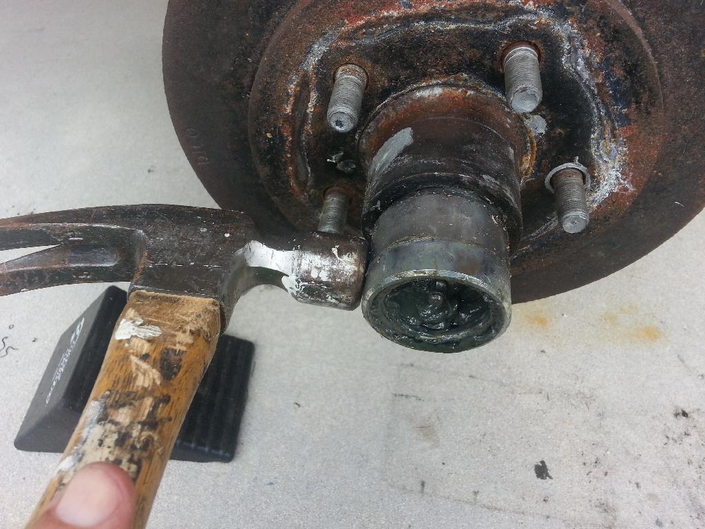

If you have a EZ lube on your hub you need to knock it off, just tap from side to side to take it off.

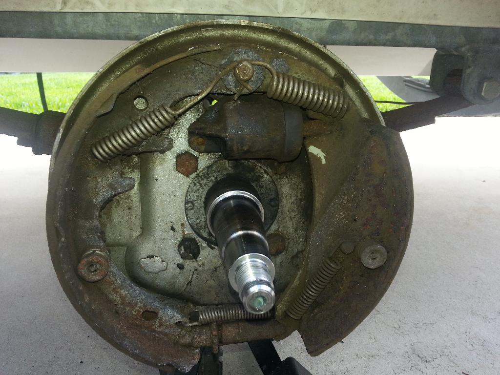

Then remove the cotter pin, castle nut and washer. The bearing will start to feed out as you remove the hub / drum, which is one unit.
Now you have the drum brakes exposed, take a pic so you know where everything goes back, if you are unfamiliar with drum brakes.

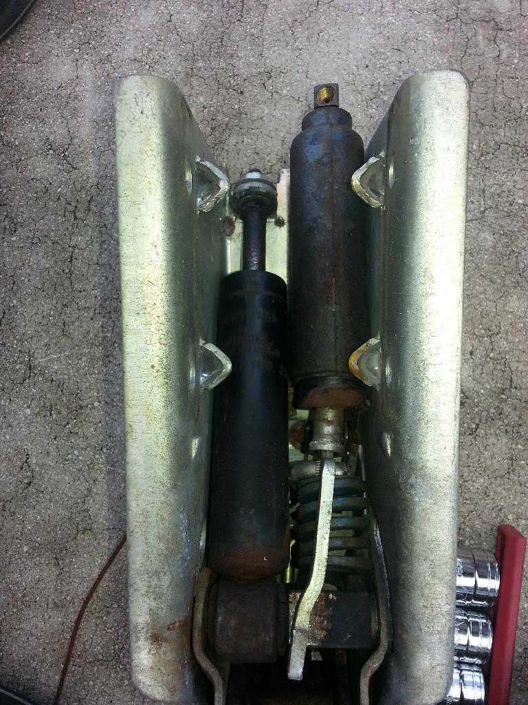

Then I moved to the coupler. I removed the brake line from the master, then I removed the 2 large bolts to the rear, and pulled the entire assembly off and flipped it over.
This is what you see:
You can see the master to the right and the shock to the left. There is 1 more long bolt that need to be removed that will allow you to unbolt the master and pull it out.
Then flip it over the loosen up the 4 bolts on the top, be careful, once loose the brake fluid can leak out, have something handy to pout it into and some rags ready in case some spills.

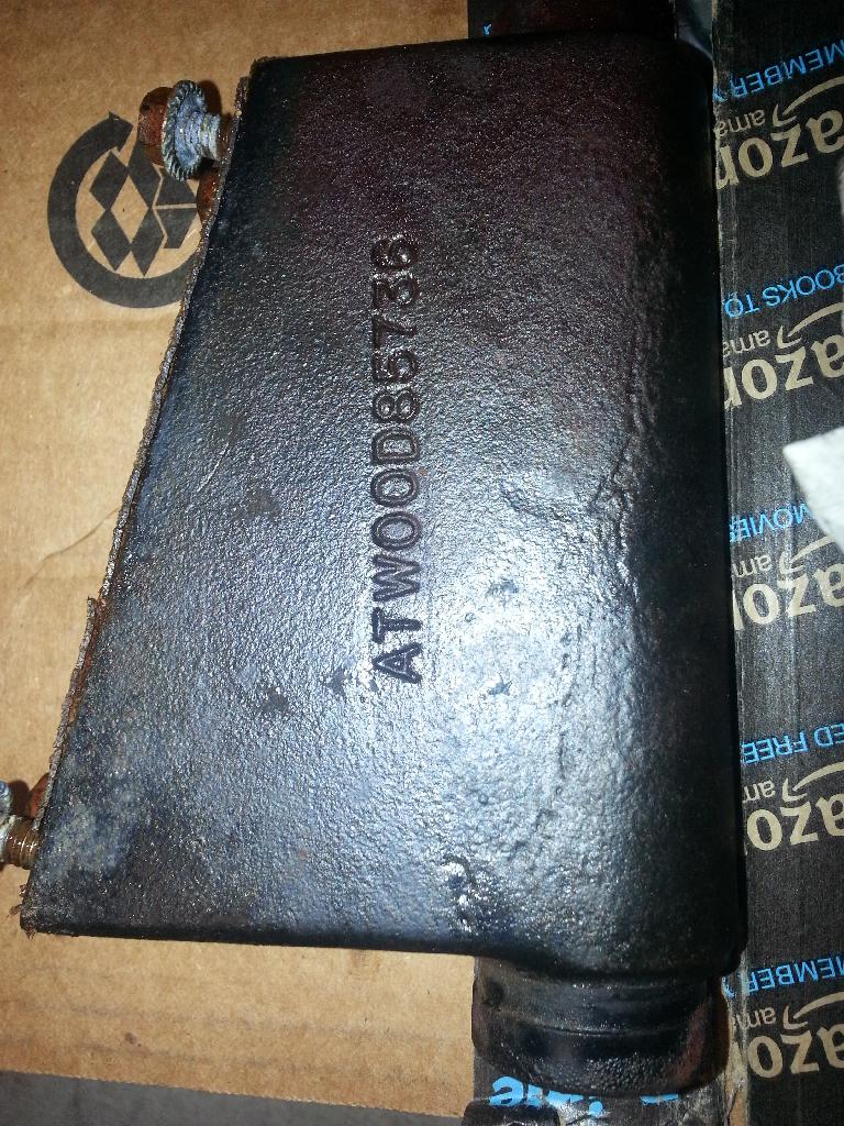

Finally!! The elusive part # I needed to start ordering replacements!
As linked above, if you have a 1999 Challenger then you most likely have the same parts as I do. Once I source and order the brake shoes I will put a link up for that. It may be this time next year though. I think I can get another season out of these. It will be close but this isn't exactly a track day and I normally do not tow more than a couple of miles to the ramp so I am good.
