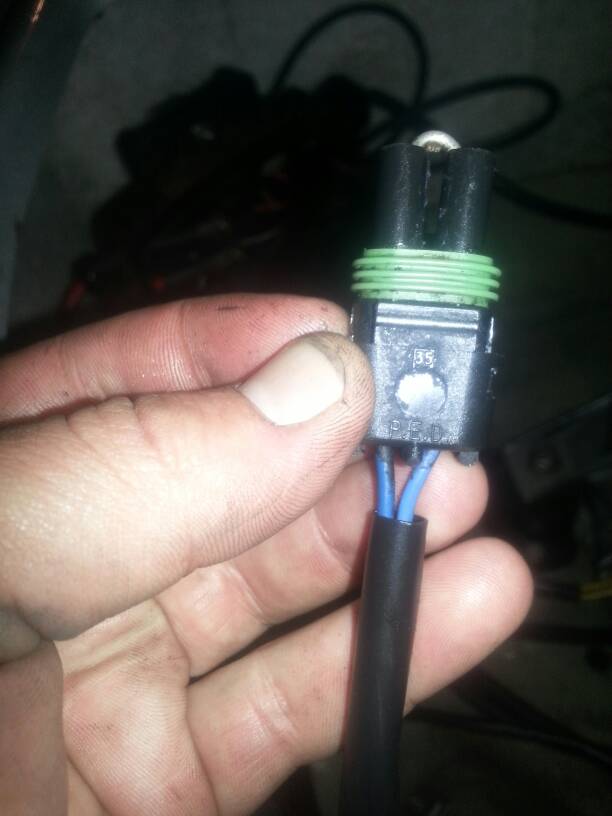

Anyone know the trick on how to bypass the low oil level alarm? I don't want to deactivate my beeper but am not running an oil tank as I've converted to premix. Ive already tried installing a jumper on the two pins on the one terminal that goes to the tank. Thanks!

Hmm what model Ski? I was under the impression most ski's still keep their oil reservoir regardless of switching to premix. I keep the reservoir full on mu 97 gtx even w/premix. Keeps the lower unit oiled.
On the 717 at least, you need to A) keep the oil tank connected to keep a constant supply to the rotary valve or B) create a closed loop system from the return looped into the supply with something like a T with a cap on it to add/remove/flush the RV oil. Not sure if it's the same on the 951 but if it has a RV its necessary
Ive just been informed its a normally open switch so unplugging it should be just fine. No jumper required. The buzzer I have been hearing is apparently a "hey u left the key in dummy" alarm.... so I'm told. I just got the ski to fire after swapping out harnesses and completing a top end rebuild. Im calling for it quits for the night... but the coffman boat lives again!
There's no RV. 951's are reed motors.
