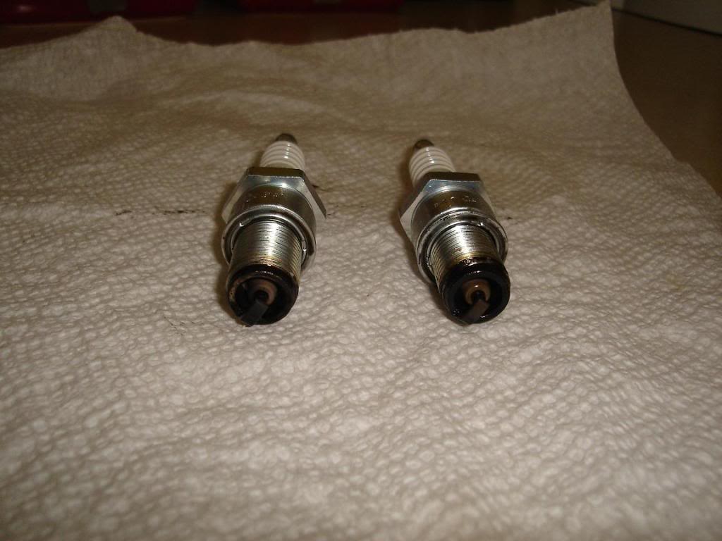

I took these plugs out after running through about 15gal breaking in my rebuild. I looked at the chart but have a hard time trying to see what I'm looking for and thought maybe some experts here could weigh in. Obviously the one on the right has a tanner color and the one on the left is darker? Any concerns anyone sees here?

Yup... they look just about right.
One question... did you have any extra oil in your fuel tank during break-in? If you did... they look a little light, and you may want to open your high speed screws a 1/4 turn, just to be safe. On a 2-stroke... I like to error on the rich side.
yea i was running injection and oil in the gas...The plugs that are in now are pretty much straight gas and injection. I'll pull them after some riding this weekend and repost and see if you guys think I should make an adjustment.

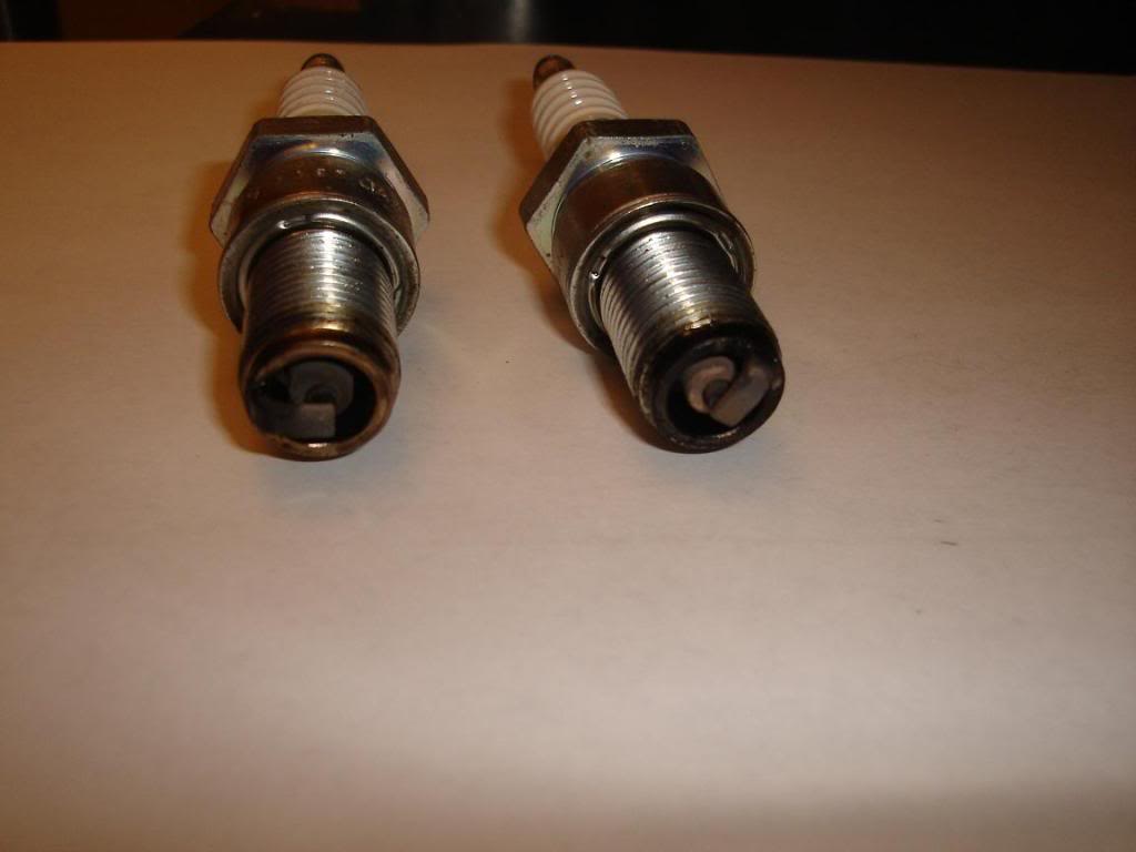

So here are the plugs after probably 8 gallons of only gas and injection oil no premix (well i'm sure there was a little left thats still mixed up in there) bust mostly just gas and injection oil. These were new plugs put in after the old pic was taken. I rode the ski around for about 10min this morning pulled it out of the water and then pulled these plugs right out. Let me know if they still look ok?
