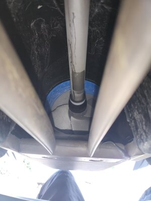

I don't see anything. I do see some dings on the impeller. I don't think they're bad enough to be causing my issue, but could be wrong...
how much space is between the wear ring and the prop? if too much you need a new wear ring and you will just be cavitating.
Typically when something is stuck in prop it vibrates the entire ski, you will feel it.
That prop looks a bit banged up.
Could the prop be loose on the drive shaft or possibly the reverse partially on ?
The impeller damage isn't enough to cause that big of a loss. There is the possibility that a bag or something was blocking the pump and it fell off after you pulled it out of the water.
The fact that your machine is new, and the picture you shared, I can tell from the look of your impeller blades that you sucked up enough rocks (it doesn't take much) to ding the leading edge of the blades up nicely, and that has very likely also caused similar impact to your blue plastic cylinder surrounding your impeller, as seen in your photo. This blue cylinder is called a wear ring, and it's name tells you what it's for. Instead of ruining the tunnel, the wear ring takes the hit, and is much cheaper to replace. It's a $100 part here in Canada, cheaper in the US. Some people replace the plastic wear ring with stainless steel ones that can take more abuse, but this isn't without it's problems too - more damage can be done to the impeller - which are many times the cost of the plastic wear ring - as well as things can be more jammed with rocks/debris between metal and metal, instead of between metal and plastic, making it harder to clear a jam and install new parts.
Grooves cut into the wear ring by the same rocks that dinged up that impeller are the majority of the problem causing your lack of thrust / speed. As Burner71 above implies, the grooves cut into the plastic wear ring by rocks eliminate your tight tolerances between your impeller and wear ring - so your impeller can't "hook up" to the water properly and give you normal thrust/speed. The reason you can get 10 mph out of it is because there is still some level of "traction" that your impeller can manage in that imperfect tunnel, but not much. BGS above mentions you can feel vibration when you have this condition. Vibration will be minor at low revs, and you will manage low cruising speed, but when you add more RPM, all you get is cavitation, typically with stronger vibration you can feel and hear, instead of increased forward thrust. Keep the revs down - high RPMS won't help you get anywhere faster, burns more gas, and more importantly, vibration/cavitation over time can lead to other problems (worn carbon rings, etc.).

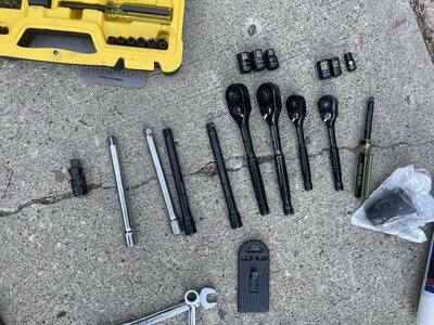

Would be just my luck lol The dealer wants an arm and a leg to replace the impeller and wear ring. It also seems like this is something that will happen more often then not the way it is designed with hardly any debris protection (shallow or not) so I had better learn how to do it myself! I'm going to pass on their service and when I get her back in my possession, I'll take her out to test your theory!
