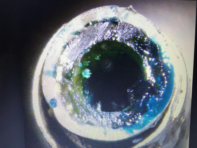

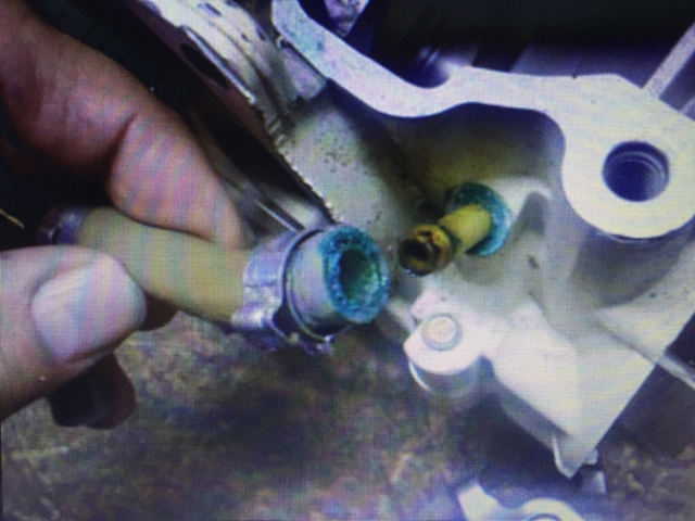

If you have Grey Tempo fuel lines, nothing else matters just yet. They are engine killers as they force a Lean condition and the pistons will eat themselves. You need to replace the lines, pull and rebuild the carbs and internal filters using OEM gaskets, replace the needle and seat as well as the fuel selector.

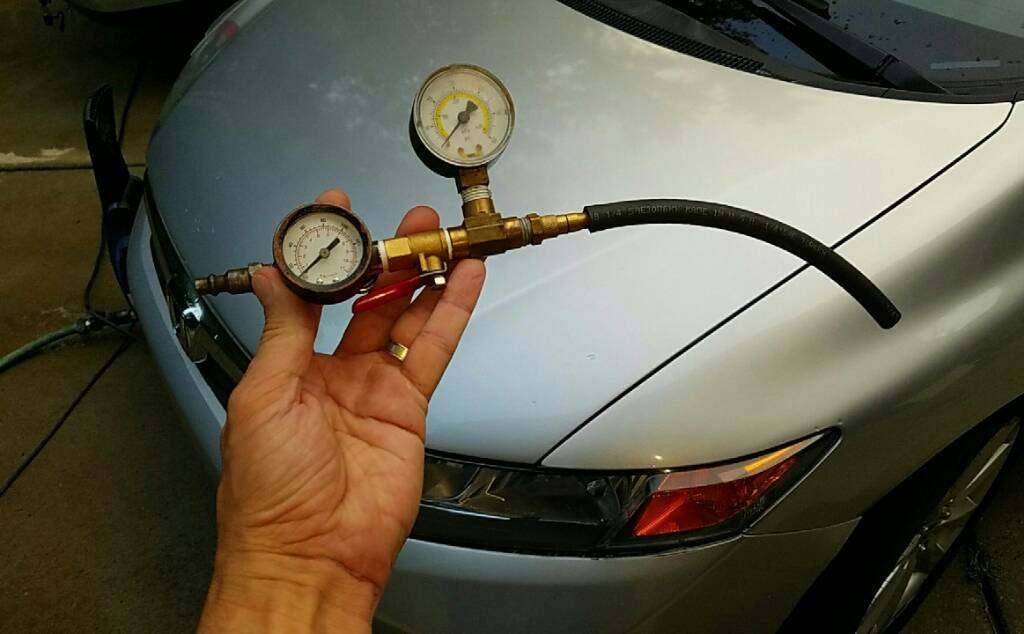

Instead of floats and bowls, these carbs have springs and diaphragms to regulate flow. Pop-off pressure refers to the pressure required to overcome the spring pressure exerted on the needle. This pressure has a range in which it should be at, and both carbs should be at the same setting. If you change the spring, you should check to make sure that your pop-off pressure is still within that range, and that the other has the same pop-off. You'll need a pop-off tester, either purchased online, or made from air compressor parts.
People usually just say to keep the original springs when redoing carbs. I built my own pop-off tester and check all my carbs every time. It's also a good idea to pressure test the carb (and spray soapy water on it to check for leaks) to make sure it is sealed properly, and also pressure test the needle and make sure it's holding pressure and not leaking. Otherwise, you're going to get hard-starting.
