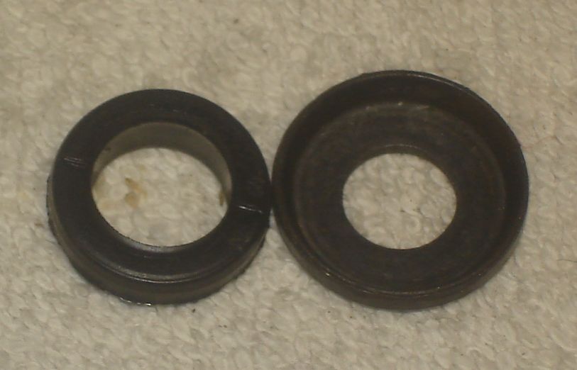

However, I have another question. I found another part on the floor that looks like it fits in this same area but is not part of any part diagram I see on the net. This piece was found a couple of feet from my working area so I am not positive it is part of the Sea-Doo or just a random piece that that I found on the floor that just happens to be the size that fits. I have a few pictures with comments...
The part in question is the second from the left. It is a thick metal washer but it cupped that the rubber grommet (left piece) fits perfectly into it. But this washer is the piece that is not on diagrams.
This is what they look like assembled. The split pieces got put together and put inside of the large nut, you can barely see a portion of them in this pictures. See how the rubber grommet fits perfectly into the metal washer?
The left piece is the rubber piece. I know this is the right part. The right piece is the one in question. It seems like this belongs there.
It makes sense that the metal washer fits over the rubber grommet because otherwise, the split pieced would be pushing against the rubber grommet.
