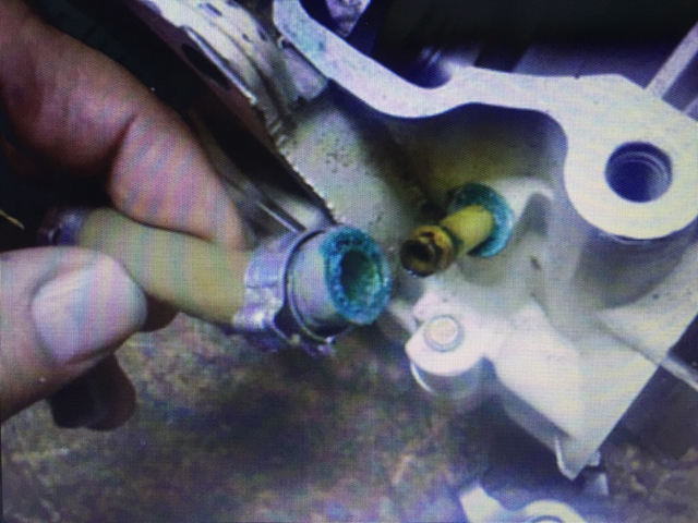

The GT fuel lines don't get blocked. They cause blockage at fittings and joints. Until you replace them, fuel selector, and rebuild the carbs with OEM Gaskets, needle and seats you are wasting you time.
Thanks for the pictures. I planned on doing both later but I guess I am going to have to step up and do it.
Typically cleaning the fuel filter and selector result in an air leak in the fuel system.
In addition cleaning the small carb filter doesn't fix anything either as the jets and pilot circuit can still be clogs and removing the small filters you can get an air leak on the fuel pump side without using new gaskets.

The selectors have to be replaced. On the filter it is the square o-ring that leaks.
I suggest replacing all the fuel lines, cleaning the tank and correctly rebuilding the carb.
If it didn't start at all now it does a little you still have something either plugged or leaking air. There is no easy fix or anything in a can that will cure it.

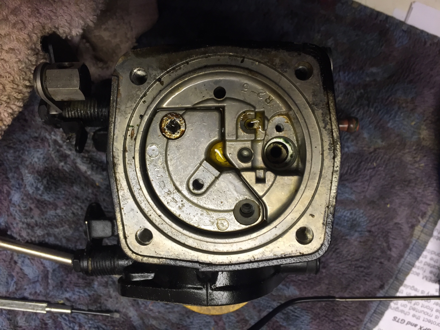

Got a chance to work on the project today. Remove carb and began disassembly for rebuild. I found gunk inside the need and seat as expected. I have one screw that is stuck. I am letting it soak in penetrating oil.
Also I maybe looking at the manual wrong but I haven't see a carb with the oil injection pump on the side like this.

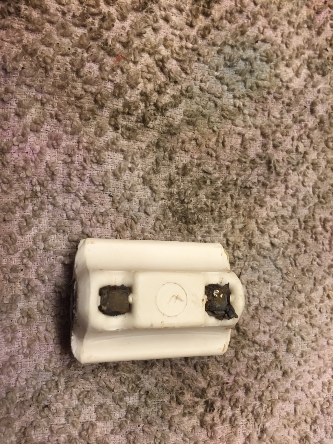

Also removed baffle and level indicator from tank Does this float look okay?

That isn't an oil pump on the carb is is the accelerator pump. It needs to be squirting fuel whe you open the throttle.

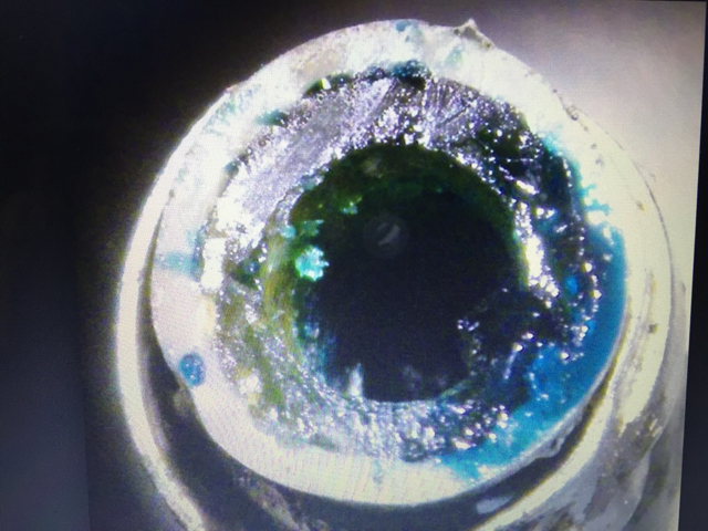

Also I can see traces of the dreaded "green goo" around the needle and seat area. How do the filters look?
Clean all the metal off the float magnets.

The selectors don't typically clean up and end up leaking air. I always replace them now. Same with the fuel strainer.
Are you using genuine Mikuni kits and needle and seats?
Sea Doo carbs use JIS screws. They look like a Phillips, but they are the Japanese version. The JIS screwdrivers are different and do make a difference when taking apart the OEM Carbs.

Well I have an SBT kit. I guess that is not Mikuni. I was planning to pressure test the fuel system and carb for leaks. Maybe I will get lucky. But as you guys described, green gunk everywhere. Who should I be ordering parts from in the future.
