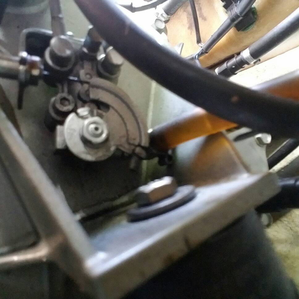

On the front cover (Magneto) of the engine below the front pipe mount you will see the oil pump. Get a mirror and you will see a small line on the lever and one on the pump housing. These two lines should line up. If they don't you will have to adjust the cable until they do. If it is out of alignment it will cause the engine to either get too much or too little oil.
Here is a picture of mine. Your picture is kinda blurt so I couldn't really tell what was what. Hopefully mine come through well enough for you to see.
What should it be?
