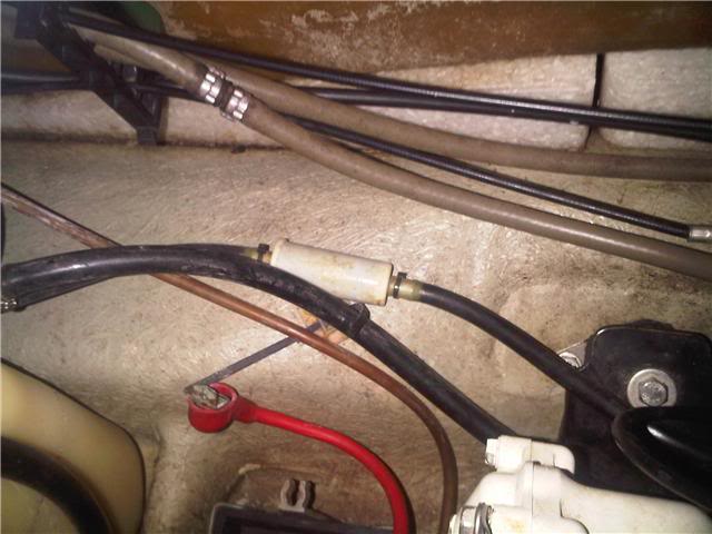

I've owned this 95 seadoo XP for about 4 years now, and ive always taken care of it... Just changed the jet pump oil...

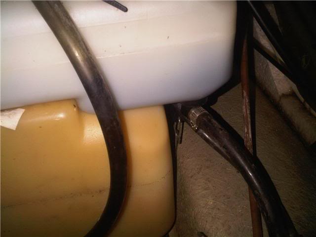

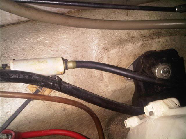

I want to know if the pictures shown, if that white filter is the oil filter? ... just checking here, the TOP tank in the one picture is the oil tank correct? FInally, Can I suction the oil out with a regular shop vac, if I put a small enough hose onto the end of the vac hose??
I bought a new one and was going to change it, then I was reading all this jumbo on bleeding, and no air, and bla bla bla... I also want to change the oil for this riding season... Should I just take this to a dealer, or is it relatively easy? I cant even find the bleeder screw.... and I dont want to mess anything up as far as getting air into the engine.
Oil Filter
That is the oil filter, I don't know if this is an approved method but I will tell you how I changed mine. I pinched off the line close to the filter going to the engine. Drained the tank using the filter as the drain, when the tank was empty I changed the filter. I put about a quart of oil in the tank and let it drain through the new filter, blow into the tank until you have the oil free flowing and all of the air out of the line and filter. Put your finger over the end of the filter and connect it to the lower line. Release the pinch off and fill the rest of the tank, you're ready to go.

With your method of pinching off the oil line, and draining, did you have any issues with air in the lines? Did you have to bleed at all??

I didn't have a problem with air in the oil lines when I changed my oil filter. Just be sure to pinch off the lower oil line, the one from the filter to the motor close to the filter, so no air gets in this line. I used needle nose vice grips (with electrical tape around the jaws so you don't damage the line). With the method I used you are bleeding the upper hose and filter. Be sure to let enough oil flow so there are no air bubbles.

Is there any position on that part of the oil line I should pinch off at? Directly next to the filter? A few inches away? DOes it matter?

Pinch the oil line as close to the filter as you can, this is the only place that could get an air bubble, if there is air between where you pinched of the oil line and the end, use an eye dropper to fill the hose back up with oil. Mine stayed full of oil, so I just plugged the oil filter onto the line.
